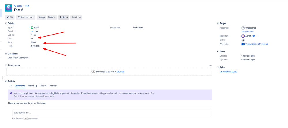

Below is a screenshot of the Post-Function configuration:-
Also, I suggest upgrading your ScriptRunner plugin if you haven't already to the latest release, i.e. 8.10.0, so you can use ScriptRunner's HAPI features to simplify your code.
Below are a couple of test screenshots for your reference:-
For this test case, I have used the Post-Function for the Create transition.
1. First, I create a new issue and add some values for the 3 fields CPU, RAM and HDD as shown in the screenshot below:-
2. Once the issue is created, I view it in the view screen, and all details have been entered as expected.

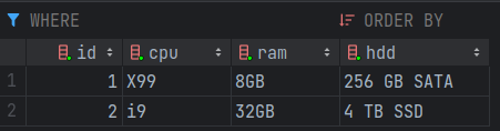

3. Next, I view the table in the Postgres Database and as expected, the details have been inserted to a new row as shown in the screenshot below:-

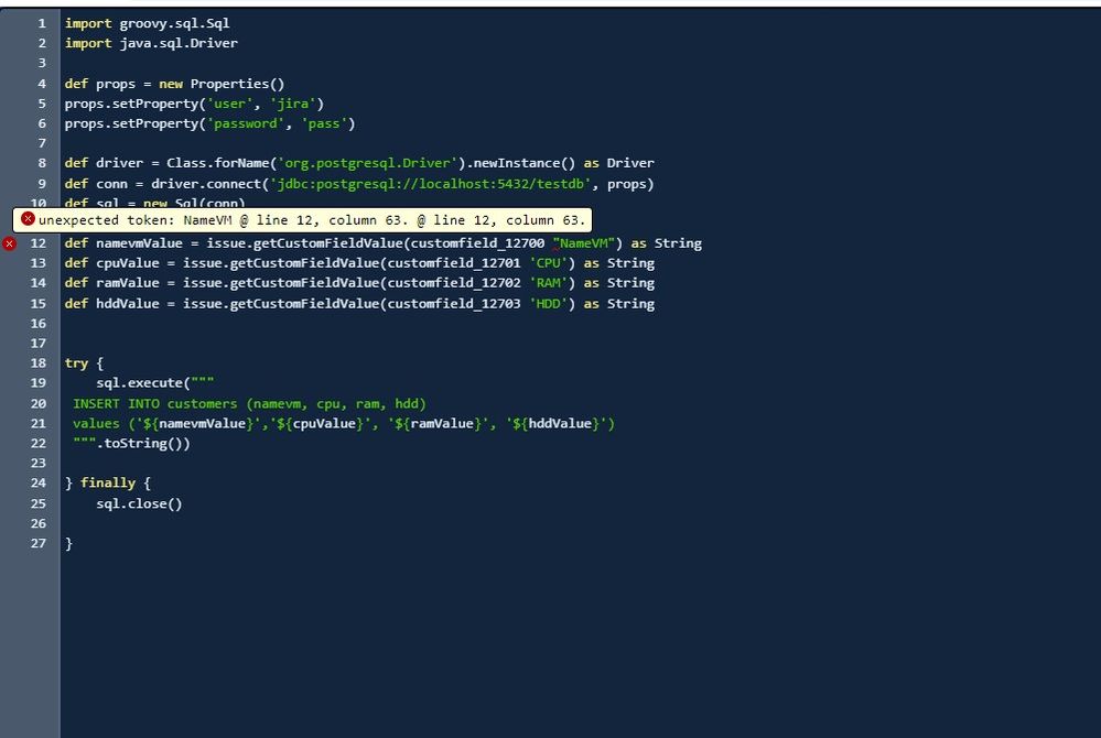

Vlad Fed
September 1, 2023
Hi @Ram Kumar Aravindakshan _Adaptavist_ thanks a lot for your help.
I made all the changes for my script but it throws an error on custom fields. I want to execute this script for JSM.Screenshot_21.jpg
September 1, 2023
Hi @Vlad Fed
You can execute it in JSM but you will need to upgrade your ScriptRunner plugin to the latest release, i.e. 8.10.0 or at least 7.11.0 to be able to use the HAPI feature.
The HAPI feature is required for the code to work.
From what I noticed in the latest screenshot you havr provided, you are using an older version of ScriptRunner. That's the main cause of the code failing.
