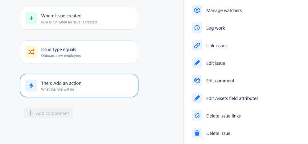

Andy T
August 13, 2024
Also, I don't see adding subtasks in the automation options at all.
my automation is
if issue is created and issue type is (i select the one from the drop down which includeds all my issue types for the project), then add action. I don't see tasks or subtast. I see create issue.
maybe I'm doing something wrong

Andy T
August 14, 2024
Thanks. I have been reading and looking at videos but I can't seem to find tasks or subtasks options at all.
This is what I see and it is a bit different
I don't see tasks or subtasks
I can create an issue which something I would like to do but then the reporter will need to be added automatically and not sure how to do that.
