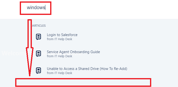

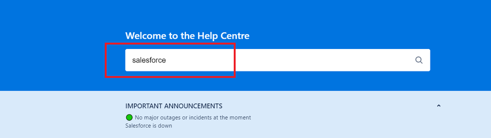

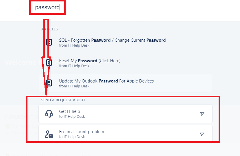

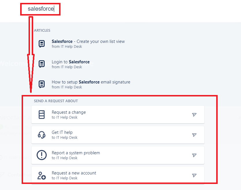

Hi there,
we are going to start using Jira Portal.
You can see from below screenshot, different keywords search show differently in SEND A REQUEST ABOUT
my question is:
1. What determines the SEND A REQUEST ABOUT list?
2. is the list configurable? if yes, where I can find this configuration and modify it
regards,
David

Nic Brough -Adaptavist-
May 24, 2021
Log into your Jira and have a look at what you see when you try to create a new request or issue.
May 24, 2021
It's searching the words used to describe the request types you have set up in the portals that this customer can see.  It's not just the descriptions of the requests, it's also looking at the fields offered in them.
