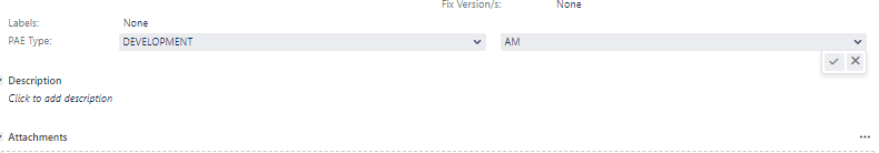

i need to add a filter to an action trigger using the value of a double select field
giovanni fantuzzo
February 8, 2024
in my board i have this field on which i have to select a father and a child value. when i try to filter the trigger based on this value using the smart value "{{issue.fields.PAE Type.value}}" the result is the trigger based only on the father value.
Vishal
February 8, 2024
Hi @giovanni fantuzzo
If I get you correctly, you are looking for a smart value for a child value of your cascading field & if so you can use {{issue.fields.Cascade.child.value}} to get it.
In your case it would look like {{issue.fields.PAE Type.child.value}}
Hope it helps
giovanni fantuzzo
February 8, 2024
It work, thank you so much Vishal for your prompt support.
