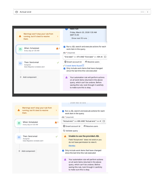

can be done for a particular service request? while doing getting this error and used JQL : project = "YourProjectKey" AND issuetype = "Service Request" AND endDate >= startOfDay(+2d) AND endDate < startOfDay(+3d)....please help me on this.

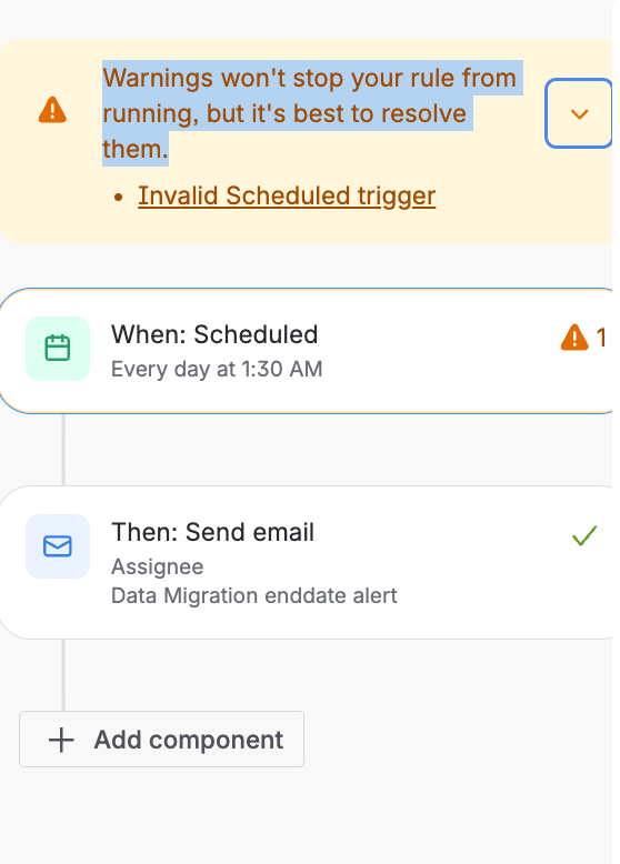

are there any details below jql input field about warning?

image (17).pngtried with both options, getting the same error, where I use the actual end field in the service request.

you have space added after end word  "Actual end "
Abilash
March 18, 2026
Checked, and the same error is getting. Let me know exactly where I am missing it. If you are done from your end, please share the step-by-step process if possible.
