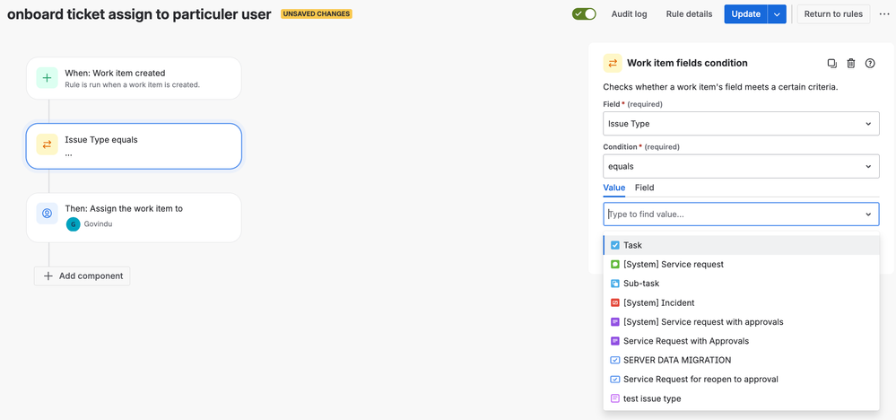

Hi @Trudy Claspill ,thanks for reply.
the given steps tried but getting difficulty at selection of the value or field

In the Condition try changing the Field to "Request Type" to see if that gives you the option you need.

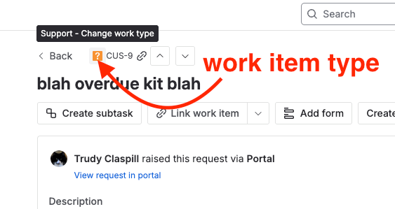

In a Company Managed Service space each work item will have a Work Item Type and optionally a Request Type.
Each Request Type is associated with a Work Item Type. Multiple Request Types can be associated to a single Work Item Type.
Request Types are what the customer sees in the portal. Work Item Types (aka Issue Types) are what an agent sees in Jira.
When an agent is viewing the item, if they hover over the icon next to the item key above the Summary they will see the Work Item Type for that item.

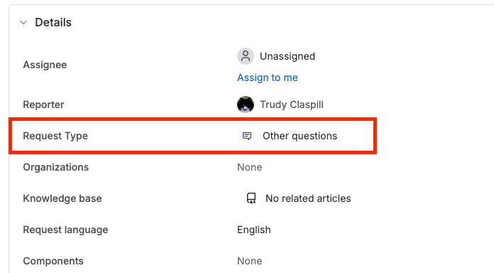

In the Details section for the item they should also be able to see the Request Type.
You need to define the condition to check that the Request Type and optionally the Work Item (Issue) Type of the trigger item are set to the values that match the types of an item you want to affect.
In your original post you said the "onboard tickets work type" which is why I initially suggested that you use the Issue Type field. It seems that "onboard" is not the name of the Work Item Type. Perhaps it is the name of the Request Type, seen by the Customers in the customer portal.
