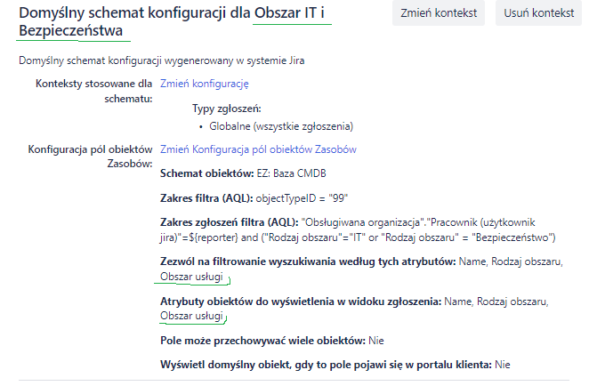

Field to be updated is a custom field:
"Obszar IT i Bezpieczeństwa" customfield_10165

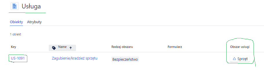

Value to be taken from asset type: "Usługa" asset Key: US-1091 from attribute: "Obszar usługi"

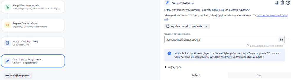

I am not sure the referred case is more complex than you need, @johan_drabarek, but in short:
  1. You need to trigger your automation rule somehow. That can be issue created, issue transitioned,  ... anything that makes sense as a starting point for the update.
  2. Next, add a Lookup Objects action to get the object details from the object linked to your issue. That should use an AQL filter that does something like this: objectType = Usluga AND Key = {{issue.<your asset field>}}. This will return a variable {{lookupObjects}} that you can use in the next step to set your other custom field.
  3. Add an action Edit issue and update the custom field you want to set. Its value should be something like this {{lookupObjects.<attribute name>}}

please see my settings:
Zagubienie/kradzież sprzętu - is my asset field which from I would like to take attibute: Obszar usługi
and put this valu into cf: Obszar IT i Bezpieczeństwa
but I get an error message:

Just 2 things, @johan_drabarek:
  • Try adding quotes to the AQL filter in your Lookup Objects action, like this: objectType = "Usluga" AND Key = "{{issue.Zagubienie/kradzież sprzętu}}"
  • And what type of field is the field you are trying to update? Is it an assets field? A plain text custom field? Something else?
If adding quotes still doesn't work, it might help to add a log action action to your rule, writing the value of {{issue.Zagubienie/kradzież sprzętu}} to the audit log, so it is clear what it returns.
johan_drabarek
October 27, 2024
Thank you Walter,
ad.1. This fixed the previous error in the audit log, but still there is an error saying: No objects found
ad.2. the field I'm trying to update is Custom Field: "Obszar IT i Bezpieczeństwa" customfield_10165
