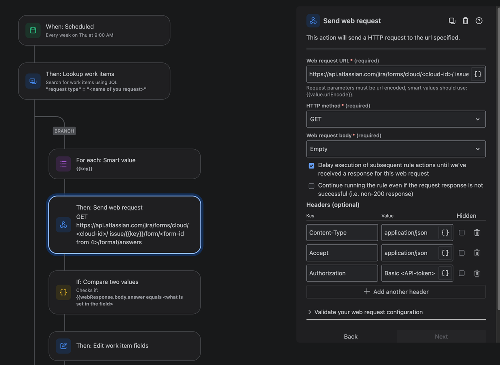

Marc -Devoteam-
August 7, 2025
Hi @Koen Bruggeman
  1. You will 1st need to create an api token, https://support.atlassian.com/atlassian-account/docs/manage-api-tokens-for-your-atlassian-account/
  2. Then get your cloud ID: https://<site-name>.atlasisan.net/_edge/tenant_info
  3. Then you will need to get the id of the form where the answer is in.
    You will need you account id and token to authenticate, also for the other calls, except in the automation rule
    https://api.atlassian.com/jira/forms/cloud/<cloud-id>/project/<project-key>/form
  4. Above will list all forms on your project, find the id that is listed as "id" where the name matches the form used.
  5. The in the automation we can do the web request.
    https://api.atlassian.com/jira/forms/cloud/<cloud-id>/ issue/{{key}}/form/<form-id from 4>/format/answers
    Where {{key} is the branch variable (if you use the example rule, in screenshot)
  6. In the edit action of the automation rule set your field and the value that the field needs to have.

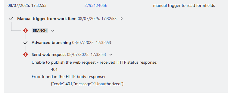

Koen Bruggeman
August 7, 2025
Thanks for your extra explication @Marc -Devoteam- ,
i think i did it correctly.
where do i paste this code elsewhere than the automation trying to fetch the list-data like so: https://developer.atlassian.com/cloud/forms/rest/api-group-forms-on-issue/#api-issue-issueidorkey-form-formid-get
Marc -Devoteam-
August 8, 2025
Hi @Koen Bruggeman
It seams you don't have access or you don't have been granted a JSM license.
The get form id action is only to get the id. This id is need in the web request in the automation

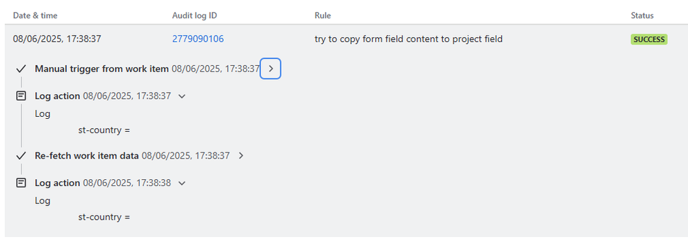

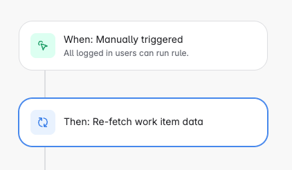

August 6, 2025
I have not tried this myself but just have you tried creating an automation that just re-fetch issue data?
I would try with a manual trigger first and test it out on a few issues to see if it works. If it works then I would change the trigger to Scheduled and add a JQL that matches the issues I want to re-fetch issue data from (if there's a lot of issues the automation can get throttled so keep an eye on the auditlog for the automation) and then I would then select to run the rule right away. And when done you can inactive the rule or delete it.
Koen Bruggeman
August 6, 2025
it sounded like a good idea, but didnt work :(
