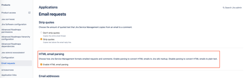

Please, go to Cog icon > Products > Email requests.
On this page, make sure to check the option "Enable HTML email parsing".

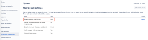

Then, go to Cog icon > System > Default user preferences and confirm if the default outgoing email format is set to HTML as well:
