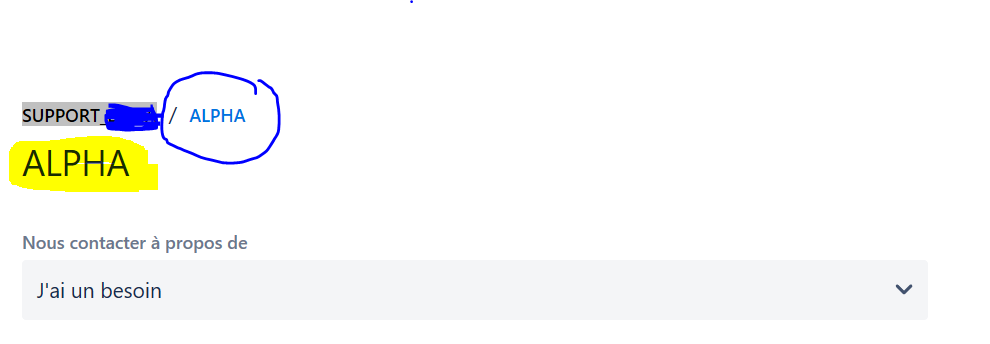

j'ai change le nom du projet mais cela n'apparait pas au vue du portail client .
J'ai toujours l'ancien nom du projet qui apparait quand une personne veut saisir une demande .

Hi fatoumatasall,
Thank you for providing the screenshot, it helped us understand what may be causing the issue.
As your portal is in French, the cause may be the language support.
Please, go to the Project settings > Language support and check everything that has a yellow dot. This yellow dot means that it has translation issues, so you will have to change the portal name on the language support as well.
Please, give it a try and let us know how it goes.

fatoumata Sall
April 30, 2019
Hi Angelica daLuz
Thank a lot  , you are rigth .
