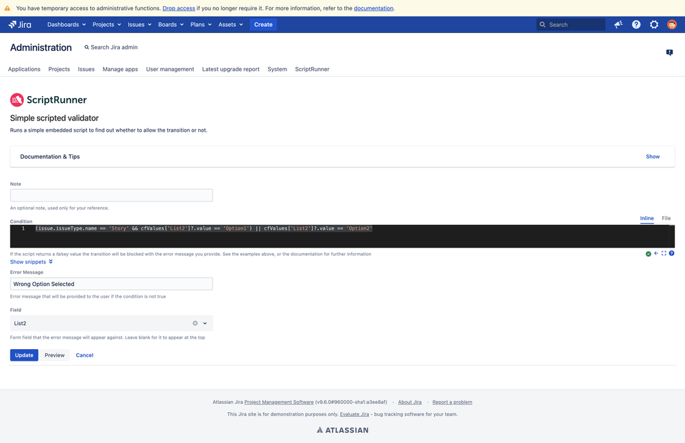

Please modify your code according to the example below:-
(issue.issueType.name == 'Story' && cfValues['List2']?.value == 'Option1') || cfValues['List2']?.value == 'Option2'
Please note that the working sample code above is not 100% exact to your environment. Hence, you will need to make the required modifications.
Below is a screenshot of the Simple Scripted Validator configuration:-
In the example above, if the issue type is Story and the List2 value is Option1, or if any issue type is selected and the List2 value is Option2, the validation will pass else; the validation error will be thrown.
