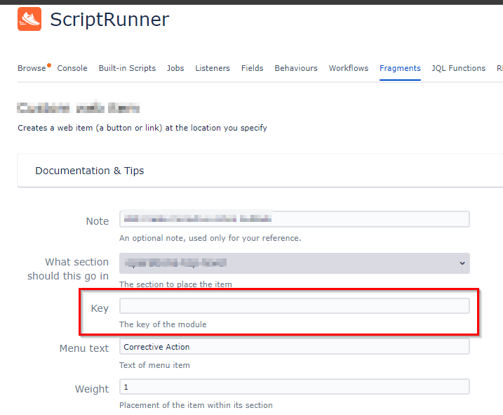

The problem has finally been solved by Adaptavist support in our case. https://productsupport.adaptavist.com/browse/SRPLAT-1442
It came from a Scriptrunner Fragment configured with the Key field empty.
The version 6.19.0 will contains a fix for this bug.
