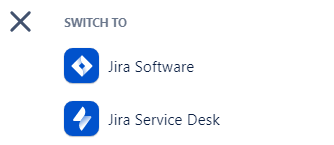

Can you tell us if you are using one Cloud Jira (Both apps installed on one Jira) or two (One with Software, the other with Service Desk)?
이창호
April 12, 2020
we are using one Cloud jira(both apps installed)

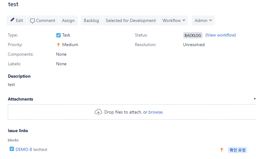

이창호
April 23, 2020
When I linked the issue, it was just a simple "link," but am I doing something wrong?
Nic Brough -Adaptavist-
April 23, 2020
The linked issue does all of that.  If you want to manage issues in a single project, then don't bother creating linked issues, but remember that you'll need to make all your developers into Service Desk Agents.
