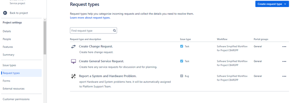

Please provide a screen image from the Request Types page under Project Settings for your project.
Kamil Askerov
April 15, 2024

So far I have not been able to recreate the issue you are having.
You said you are an admin for Jira Cloud. Have you specifically been granted a Jira Service Management agent license? Have you been assigned a Service Team Member role in this Service project?
How exactly did you copy the issues from the Software project to the Second vice project?
