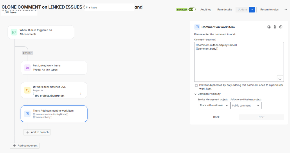

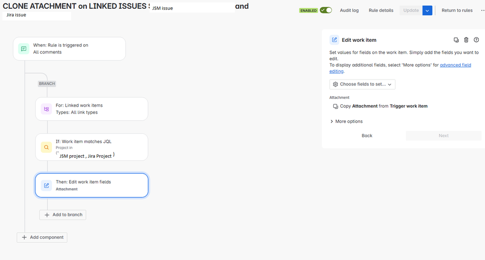

Hi. I have problem of cloning comment and attachments with automations.
I had automation where I had clone comment and if this comment had attachment(s), this comment cloned with attachments. But I have problem if someone dont write some comment , only attach some file. This automation dosnt work.
To solve this problem , I decided to make 2 automations, 1 for cloning comment, other one for attachment.
But it have problem - my automation limit for month (5000) its about to end.
Therefore I need only one automation for this. Thinking somebody helped me with solving this problem.
 My automations are here :

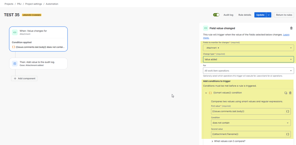

Evgenii
July 18, 2025
Hi, @Kamil Askerov
I think I understand the issue now.
You have two scenarios:
  • A user adds both a comment and an attachment
  • A user adds only an attachment, without a comment
You want to clone either both the comment and attachment , or just the attachment , to another issue — and you want to avoid using extra rules or unnecessary automation.
In this case, you’ll need two separate rules , because the triggers can fire either when a comment is added, or when an attachment is added.

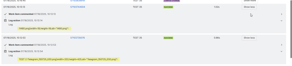

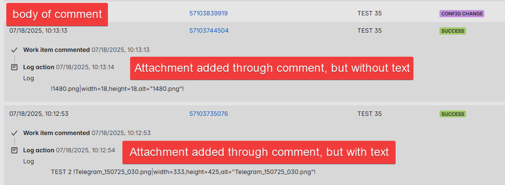

However, if you apply the condition I suggested earlier — slightly adjusted to check whether the last comment body doesn't contain attachment filename — you can achieve exactly what you're aiming for. Here's how it would look in an example...
This rule checks whether an attachment is added and its filename is not mentioned in the comment text. Here is example of comment body, when attachment is added with comment:
If both conditions are true, it means the attachment was added separately (without a comment). In that case, the rule will clone the attachment to the target issue.
This helps ensure that attachments are copied only when they're not already referenced in a comment.

Evgenii
July 21, 2025
If attachment is added through comment, comment body contains specific text:
You can check, that comment body contains specific text, and if yes - copy attachment.
