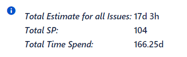

I can use below JQL to calculate and display the result:
project = [project_key] AND issueFunction in aggregateExpression("Total Estimate for all Issues", "originalEstimate.sum()", "Total Time Spend", "timespent.sum()", "Total SP", "storypoints.sum()")
