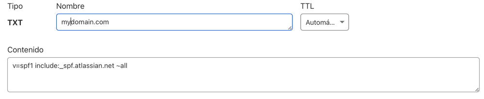

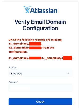

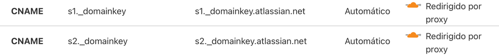

I already set CNAME and TXT but I got the same message "DKIM the following records are missing "

Thank you for the screenshots, @Nub8 LLC.
For the DKIM records, it’s necessary to copy exactly the same as the documentation. So, please, add a dot after the .net.
s1._domainkey IN CNAME s1._domainkey.atlassian.net.
s2._domainkey IN CNAME s2._domainkey.atlassian.net.
Also, checking your domain on https://mxtoolbox.com/SuperTool.aspx, shows that there are multiple SPF records. Please, use the example below to add both of the records:
Here is a validmulti-record SPF example where Google is the second provider:
v=spf1 include:_spf.atlassian.net include:_spf.google.com ~all
