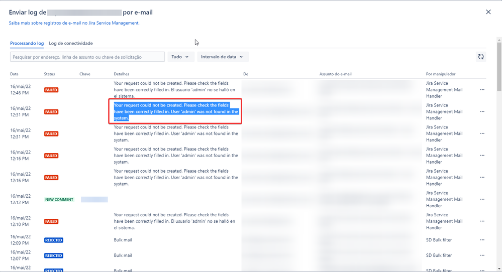

On the e-mails logs the the message is:
Your request could not be created. Please check the fields have been correctly filled in. User 'admin' was not found in the system.

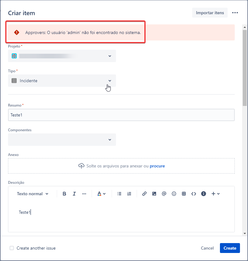

And when I try to create an issue as an administrator or an "service desk team" it shows the follow message:
Approvers: User 'admin' was not found in the system.

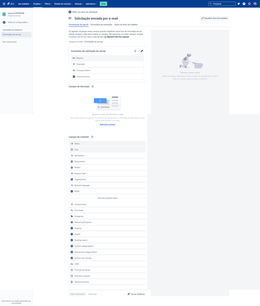

If you edit the request type Solicitação enviada por e-mail does it have any hidden fields?  I am assuming it does and that one of them has the user 'admin' set when the issue is created.

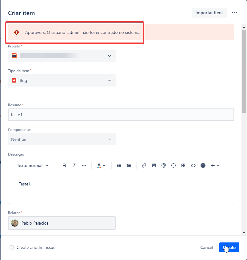

After testing we noticed that the same message it's showing even with tickets from the Jira Software platform in different projects that doesn't even use the same workflow. I'm gonna try to see if an Administrator of our site changed something or removed some "Admin".
You mean the fields "Hide when empty"? We have a lot that we don't use. I may try to remove it. But I'm not so shure because it's happening even on Jira Software, completelly outside JSM.
These are the fields of the request type for e-mails:
screencapture-monitortdtb-atlassian-net-jira-servicedesk-projects-SUP-settings-request-types-category-service-requests-request-type-10-2022-05-16-15_07_40.png

E-mail log:
Creating a ticket inside:
Creating a bug in Jira Software on a different project:
