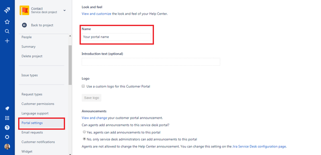

I think the variable in your customers notifications is the portal name rather than your project name - could you please check if you also did change the portal name?

Ok, can you please share the customer notification email template (https://yoursitename.atlassian.net/servicedesk/admin/yourprojectkey/customer-notifications/template)? What variables are in the subject?
Could you also share a screenshot of a notification email and highlight the part you'd like to change? I'm not sure to understand where the old project name is remaining.

I can confirm that the From: field populates from the Portal Settings page's Name field as @Manon Soubies-Camy has shown via screenshot.
