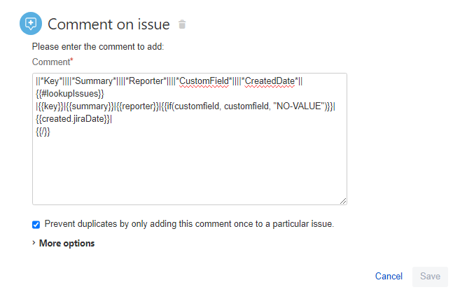

If you need, in your comment, a table of data from lookupissues, After your if condition, you can put below in your comment section (see screenshot below). Modify according to your fields.
||*Key*||||*Summary*||||*Reporter*||||*CustomField*||||*CreatedDate*||
{{#lookupIssues}}
|{{key}}|{{summary}}|{{reporter}}|{{if(customfield, customfield, "NO-VALUE")}}|{{created.jiraDate}}|

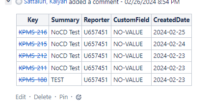

Gives below table in comment:
NOTE: field names are case sensitive.
Summary is wrong and will not give you data. summary is correct.
In my table I have a if condition to check if value is null, if so replaces with NO-VALUE.
You can do the same for your "Else" condition.

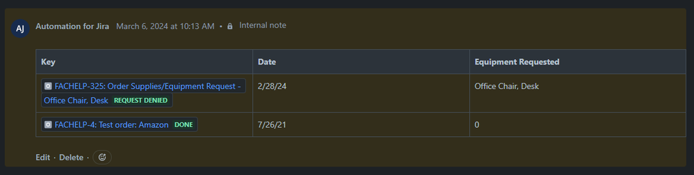

David Quiram
March 6, 2024
That worked! Thank you so much!2024-03-06 10_14_44-[FACHELP-325] Order Supplies_Equipment Request - Office Chair, Desk - Jira.png
