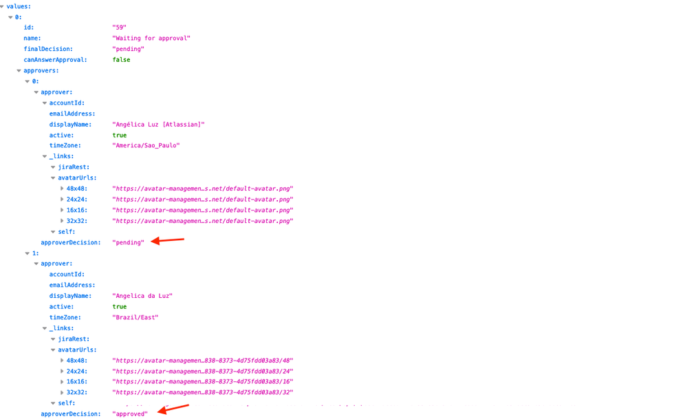

I tested on my local site and doesn’t matter if it’s filtered by a single user (using the account id), it will show all tickets pending approvals. I also checked the automation thinking of copying the value of the field or sending an email, but I didn’t find the option to remove who already approved.
For now, it’s possible to see who still needs to approve directly on the ticket or via API using: https://xxxxxx.atlassian.net/rest/servicedeskapi/request/IT-123/approval
Other than that, there are no other options we can think of for now.
