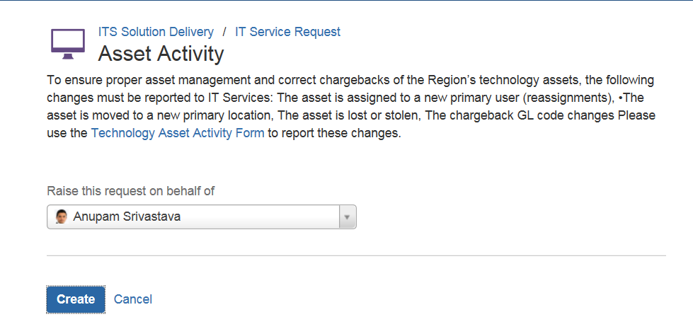

As part of our traditional help desk processes we have had a number of customized forms built over the years. As we transition over to service desk, there is a recognition that for some of those help desk tasks, service desk forms may be a bit limited in its abilities and so the plan is to rather just create a headline request item within service desk and then when a user clicks on the specific request type, it just displays a message with a link to create request in the old system. However, within JSD, this is still a type of service desk request and so it still shows the Create and Cancel buttons at the bottom.
Our requirements is to hide the create button for such type of requests.
I hope that helps clarify my position. Also, for easy reference, I've attached a screenshot of such a request.
