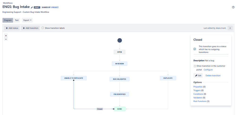

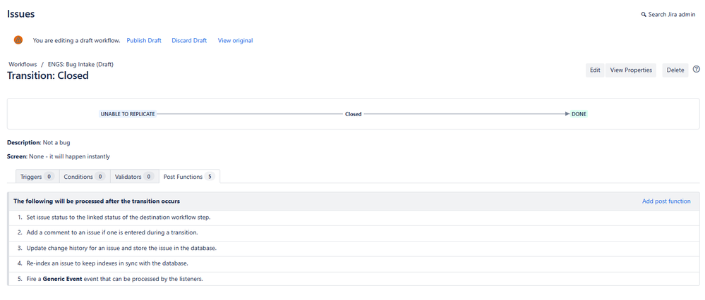

Let's take this workflow as an example. For the transition from the status 'Unable to replicate' to 'Done', there are 5 post functions.
When I check what they are, I can see that the this transition is calling a 'Generic Event'

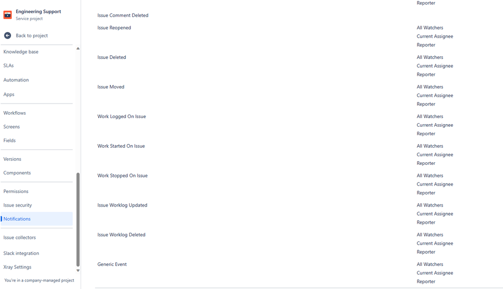

Now, you need to check in the project's notification scheme, in this case, who should receive notifications for a generic event.
The solution depends a bit on your setup. If the workflow is used in more projects, you could modify the notification scheme.
If the notification scheme is used in more projects, it might make more sense to modify the workflow.
