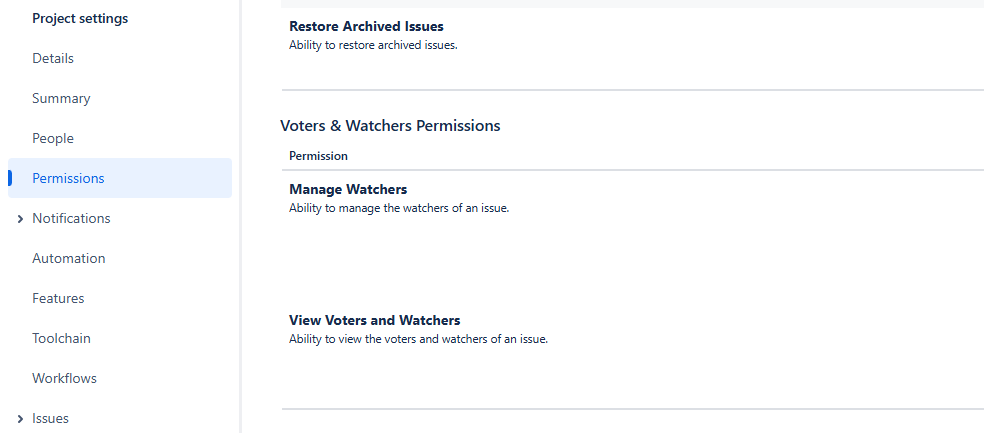

Did you already have a look at your permission scheme?
There is a "manage watchers" permission, which has to be set to the user performing this action to be able to add or remove a watcher.

Hi @Anagha Narayanan , welcome to the Atlassian Community and thanks for your question.
Being able to manage watchers is a project permission.
Please can you check that the impacted users are enabled to the Manage Watchers permission?

Thanks for the quick response. As this project is a team-managed one,I am not able to see the project permission to add watchers here.Can you help me with the navigation in Team-managed project settings?
Also the user is having access to the project and he/she was able to add watchers before.

Hi @Anagha Narayanan , thanks for the clarification.
I found this documentation which explains the project permissions in team-managed projects - https://support.atlassian.com/jira-software-cloud/docs/next-gen-permissions/
You have to give the administrator role to anyone you want to be able to add or remove issue watchers.
