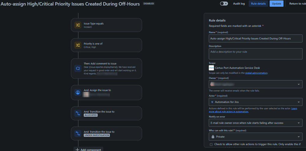

I've been trying to automate ticket registration in the off hours in order to catch first time to response SLAs in JSM. I have put the following together:
This is how it looks:

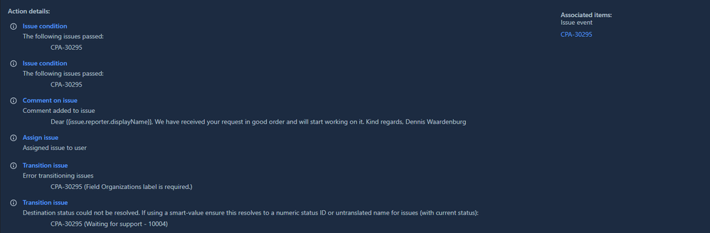

This is the log file where there is an issue in Transition Issue part:2024-09-30_14-38-35.png

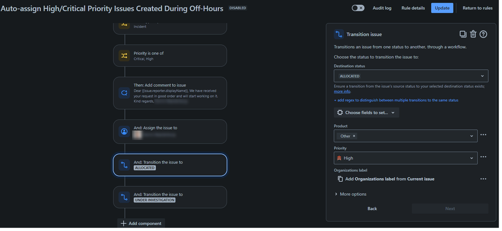

When I look at that part, so at "Allocated", this is how I set it up:2024-09-30_14-45-38.png
When running this with a test organization and test user I also get this error:
Transition issue
Unknown fields set during transition. Field may not be on transition screen. Fields ignored -
Organization Label (customfield_10080)
When checking the project settings - workflows i see it is an optional field. So now i am confused...help?

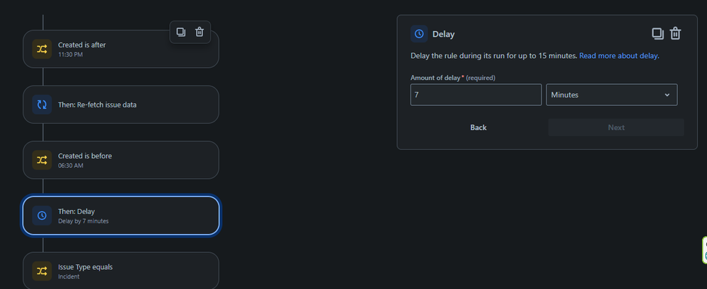

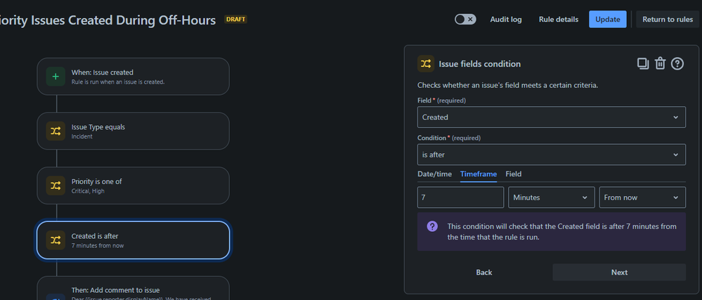

I now have another puzzle - how do I postpone when the automation is run? I need it to run 7 minutes later than the ticket's created time. But the option in my screenshot is not the right setting it seems. I tested it...Anyone any ideas?
Jakub Koc
October 4, 2024
FYI in this automation you check that if during creation your ticket was created 7 minutes later, which logically doesn't make any sense;D
Berik Irgebayev
October 4, 2024
i figured it out. Had to put action "Delay" at the beginning en boom! it works
Thanks for the comment though :P
Jakub Koc
October 4, 2024
Huh, can you share screenshot? I don't recall anything like this.
Berik Irgebayev
October 11, 2024

Hi @Berik Irgebayev ,
I have a few questions to help me better understand your automation,
When is the organization label set, is it also automation based?
What's the trigger for the automation?
Can you share the workflow or confirm that every transition that you are making is in correct order and meeting all the workflow conditions?
Also I think that in between of your transition actions should be 'Re-fetch' action to make sure it's properly refreshed between transitions.

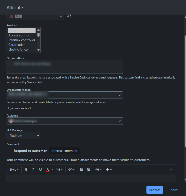

Regarding organizations label - I am not sure it is automation based. I do not think so. When we allocate a ticket that just came in by hand, we see this prompt appear:
Going top to bottom all these are mandatory fields (or required fields) in order to be able to allocate the ticket.
Organization is usually already pre-filled based on the customer who reported the issue.
Organizations label we have to pick manually from the drop down menu. So I don't think it is based on automation. Quite frankly if I knew what effect it would have on the overall flow within this project, I would remove that required field all together. But that's for later.

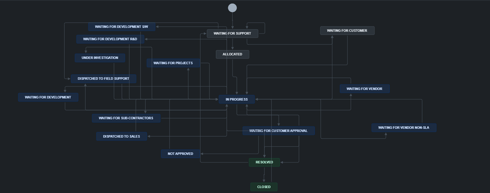

This is our workflow. In order to be able to go ANYWHERE, you gotta go through that Allocated status first.
Jakub Koc
October 1, 2024
Okay, so from my understanding the behaviour your are currently experiencing
1. Transition Issue - Caused by missing information about Organisation Label
- Either the automation that usually sets it doesn't picks it up before your automation, or from what I see you are just setting it up manually while transitioning the issue just as you showed on the screen.
In that case you might want to add what @Cristian0791 suggested, action to set that value based on reporter email domain for example or basing on the Organisation field that you mentioned is pre-filled.
2. Transition Issue - information about the issue isn't automatically refreshed in the middle of automation, that's why when you try to transition to "Under investigation" Jira reads transition from "waiting for support" to "Under investigation" which is not part of the workflow.
Adding a function to "Re-fetch" the issue between both transitions should fix the problem, and also one more transition or change to workflow.

1. The Organizations Label has always been picked manually indeed, before you can transition from Waiting for Support to Allocated. That part is not automated. The organization, however, is pre-filled based on the reporter
2. In my workflow screenshot you can see that to transition from Waiting for Support to Under Investigation, there is Allocated. Which is what I also made sure to have in my Automation. That the automation follows what the workflow is (i.e. Waiting for support to Allocated and then to Under Investigation).

Normally ticket comes in:
1. I transition it from Waiting for Support to Allocated
2. Prompt comes on screen to fill out Priority, product, Organizations Label etc (see screenshot)
3. I press on Allocate at the bottom
4. Transition from Allocated to any status I want. In this case Under Investigation.
Jakub Koc
October 2, 2024
1. In this case you can automate it basing on the Organisation field either by copying it if it's the same or creating if conditions/branch rule to set a proper one.
2. Tbh I don't see transition directly from allocated to under investigation but okay,
Still re-fetching is something that in my opinion you should do here, it basically just refreshes the data on the issue and without it you might run into trouble running your automation as it would read the data wrong. It's not like it takes long time and it's always good to have up to date data:)
This part of automation should look like this then:
Transition to "Allocated"
Re-fetch the issue
Transition to "Under Investigation"
Berik Irgebayev
October 2, 2024
oh wait, Jakub, you are right...only now I see that there is indeed no transition from allocated to under investigation....it first goes to in progress!
Thanks for your advice, I gotta look at this whole thing again more attentively.
