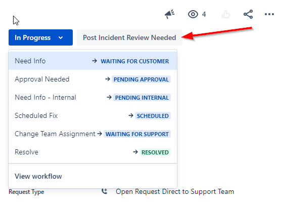

We woke up today to the Jira UI being different. In the new UI on the right hand side, we used to see the current status and a dropdown that allowed us to transition the issue to the other available statuses.
Now we see one of the statuses that used to be in the drop down now show up next to the status:
How do we configure this so that we can either:
1) Turn this off so that all transitions show up after we cluck the dropdown button
or
2) Configure which transition shows up next to the current status?
I've already looked at the "opsbar-sequence" property on the various transitions... some have the property, most don't, and I can't find any relation between the opsbar-sequence and what I see in the UI.
I also have noticed that some of my transitions are italicized:
But there diesn't seem to be any explanation (that I can find) for that.
So, I'm stumped. How can we configure the transition that shows up next to the current status?

Something to note: "Post Incident Review Needed" is a loopback transition: the origin and destination are both "In Progress".
I wonder if that has anything to do with it?
Okay, I just removed the "Post Incident Review Needed" loopback transition and now the "Post Inicdent Review Needed" button is gone
and
Dropdown honors opsbar-sequence.
Thus, it would appear that if there is a loopback transition, opsbar-sequence is ignored and the loopback is showed as a button directly to the right of the status button.

Unfortunately, it didn't work. I verified that every outgoing transition from "In Progress" has an opsbar-sequence value that is an integer, ranging from 10 to 500.
The transition that has the lowest opsbar-sequence is "Need Info":
But after publishing the workflow the transition button next to the current status remains unchanged:
FYI: "Post Incident Review" has an opsbar-sequence of 400 (which comes 5th in the list of transitions).

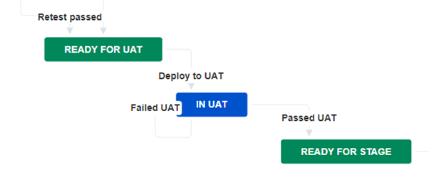

Hi @Joseph Chung Yin ,
To your second question, yes. To your first, I'm not the OP but have a similar example. Here's my workflow:
And what I see on an issue:
As you can see, 'Passed UAT' and 'Cancel', both of which transition to a different status, appear as Drop Down items. 'Failed UAT' that transitions back to itself, is represented as a button.
If I change me workflow to direct the transition 'Failed UAT' to a different status I can see all three transitions as drop down options and nothing as a button.

I am currently trying to repo your issue of having a status to have a transition back to itself. Stay tuned.

> @Nathan Given True but this doesnt answer the question. The question is why it appears as a button and how can we have it in the dropdown menu without having to create a separate Status
Sorry about not answering your question. I'm not an atlassian employee, however, based on what I've read and my understanding, loopback transitions currently appear as buttons instead of appearing in the dropdown. (And they haven't made this configurable :-( ).
For whatever reason, atlassian decided to code things up this way. Perhaps their UX designers thought it was a great idea and unfortunately, that design doesn't work for everyone ( me included ).
We've just had to "workaround" the issue by living with it.
