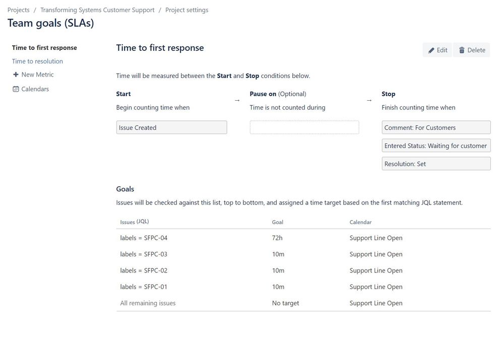

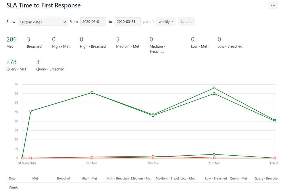

Please see the image for the settings for the Time to First Response SLA. When we run a report e.g. for March 2020 the number of requests being shown in the report is only two thirds of the number of overall requests for the month e.g. there were 497 service desk requests created but when we run the Time to First Response report it only shows 297. Can anyone tell me why the report is only showing some of the requests as i would expect to see the report show me the Time to First Response for all the requests as per the goals set. We have checked and all the requests are labelled correctly.

sla setting.JPGThe SLA was set prior to the beginning of March so it should bring in all requests. Hopefully the image will show this time.
Jack Brickey
April 16, 2020
Based on the goals I would expect the following to occur:
  • all issues with a label of SFPC-04 to have an SLA that would breach at 72(h
  • all issue with a label PF SFPC-03, 02 or 01 to have an SLA that breaches in 10m
  • all other issue would not have the time to first response SLA
so my question is, for the issues that don’t display the SLA do they have any one off the four labels? If not then it is working properly. However if one or more has the label and no SLA then that is an issue. Please share an image of such.

That's correct that is exactly how it should work. We have run a report and all issues for March have been assigned with one of the labels:

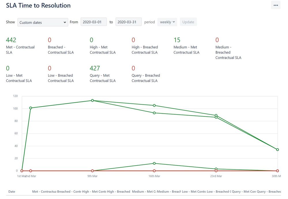

unlabeled.JPGAs you can see below the Time to First Response only picks up 286/482 requests:time to first.JPG The Time to First Response (below) picks up most 442/482 but not all requests:

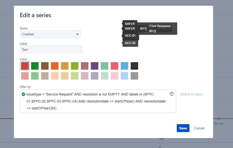

It is difficult for me to troubleshoot at a distance but my theory here (current) is that the error is in the way you are crunching/assessing the results. To test this let’s simply things by moving away from these reports and into JQL queries.
create the following JQL
project = xxx and resolution is not empty and labels in (1,2,3,4) and resollutiondate >= startOfYear() and resolutiondate <= startOfYear(3M)
Hopefully I have the correct syntax here. note I shorthanded the labels here so expand. This should give you a total number of issues that have been resolved in Q1 (met and breached. How does this number compare to your Time to Resolution chart.

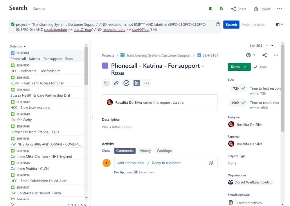

query.JPGI am new to JQL, I did not get a project option so have run the query on all created service requests but it is returning 0 so I know I have done something wrong. Can you see what it is? Thanks for your help with this.

Sorry. What I mean is to run this query in the Advanced search screen not in a Report.
  1. click magnifying glass (assuming you are still on old navigation where it is on the sidebar)
  2. click Advanced search
  3. click on switch to JQL and paste the search in the search bar
one thing to point out here is that the met/breach report only show issue that have been resolved not issues still open. That may already be obvious to you.

I don’t have the new navigation but appears to be so. Now I see 804 issues listed here so something is amiss with you previously mentioned 400+ issues. Again I’m quite confident we are simply dealing with understanding what the report is showing us. Try adding “and “time to resolution” = breached()” to the JQL. This should give us the total number of breached issues in Q1.

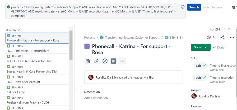

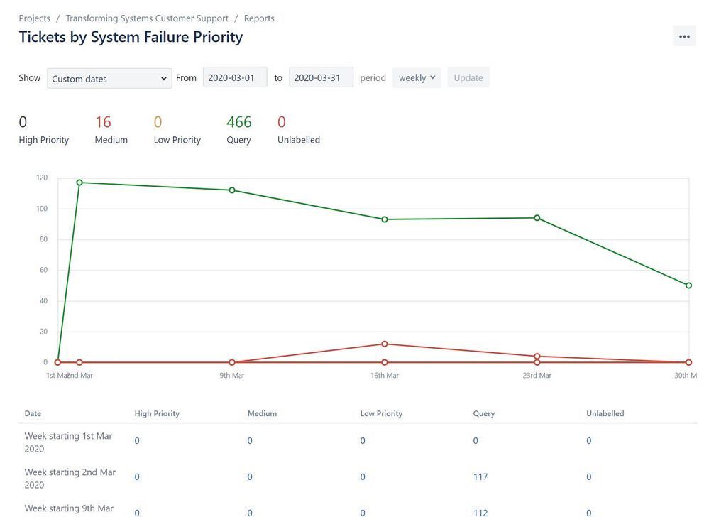

I don't think the first two queries were right to show just March which is what i m looking at, the query above gave me 459 so this is inline with the Time to Resolution numbers but as we know not the Time to First Response numbers. will try adding in the time to first response met thanks

Met.JPGThis is the number met which matches the Time to First Response report
Below is the number breaches which matches the Time to First Response report

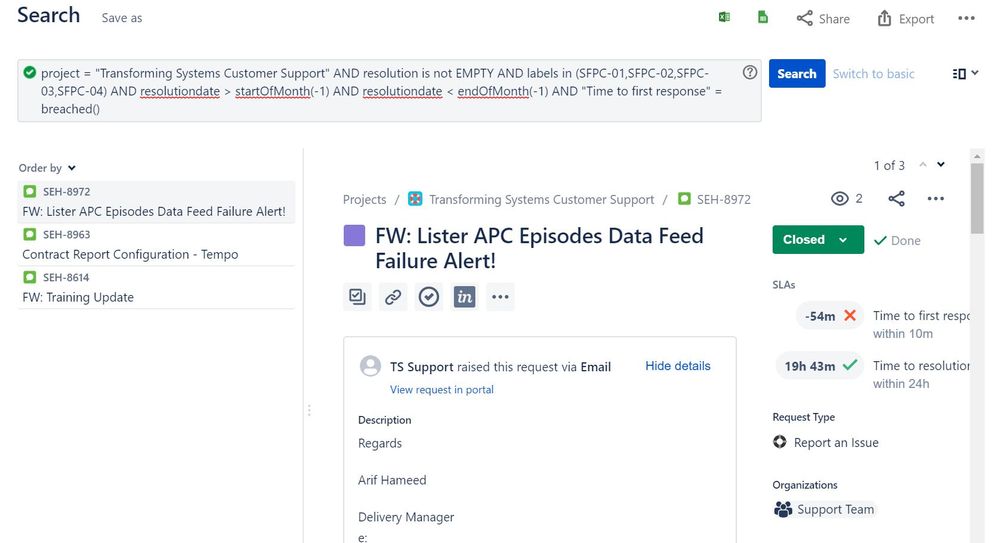

when i changed the second query to time to first response i get 3

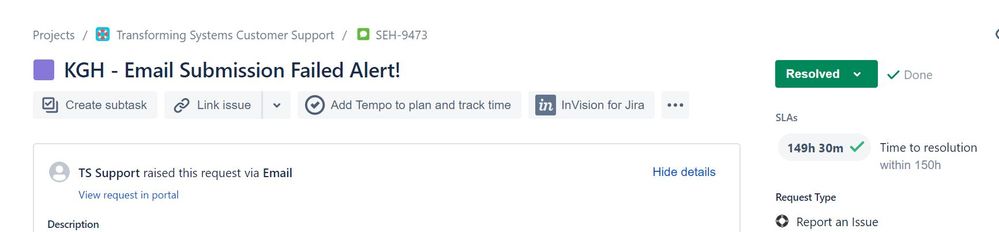

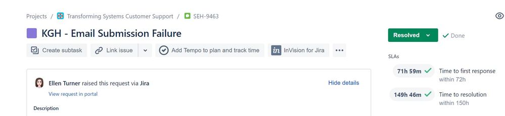

Sorry to post again but i have notice this, some issues are not showing the Time to First Response:
no time to first response.JPGand others are as below and these ones are in the report and the above ones are not and there does not seem to be any clear reason for this, am i missing something obvious?
Jack Brickey
April 17, 2020
does SEH-9473 have one of the 4 labels on it AND was that label added at create time. if added after the fact it will not trigger. BTW...labels are a really bad choice for things like this as it is a free text field. I would encourage you to consider using a select field, Components, etc. and require it to be selected at creation time.
