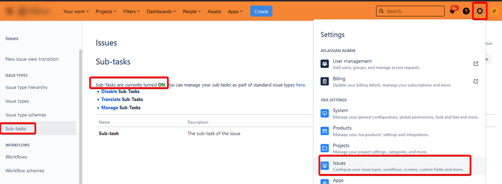

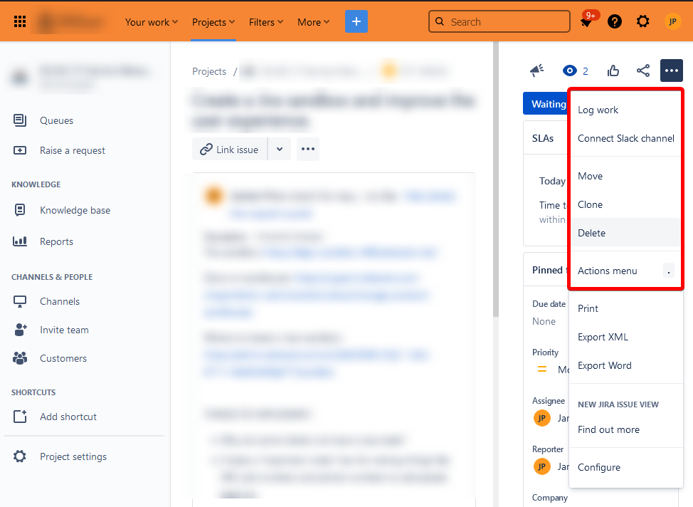

Using Jira Service Management and our project is using the "IT Service Management" template I believe. We don't have a "create sub-task" option when clicking the overflow menu on a ticket. I was wondering if anyone knew how to get it back?
Under "Issue Settings" sub-tasks appear to be turned on:

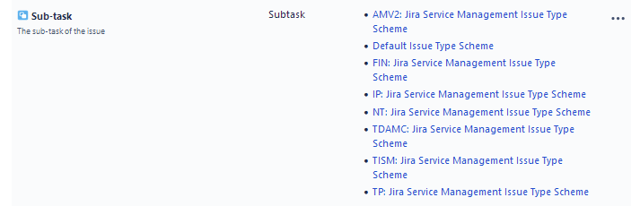

Thanks. This might be getting closer. When I go to Settings > Issues > Issue types the "sub-task" type exists and is related to a number of schemes:

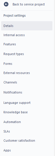

I can't however confirm what scheme is associated with my particular project as when I go to "Project Settings" I expect there to be an "Issue Types" option where I can see what scheme is in use, but that option isn't there:
As such I believe I have no way of knowing what scheme my project is using and in turn can't confirm whether that scheme is related to the "sub-task" issue type or not.

Ah, it sounds like you might be using a Team-managed project. Can you verify if it is Team-managed or Company-managed? Team=-managed projects do not use schemes.

David A
February 10, 2023
Hello Jamien,
You must dropdown the option "actions menu" in the issue and there appears create subtask.
Hope this helps!

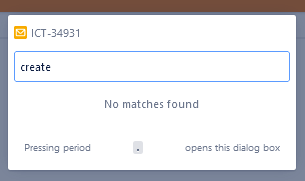

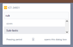

Jamien Price
February 12, 2023
Thanks David,
I'm afraid that when I open the action menu and search for "create" nothing appears:
And when I search "sub" I get a single entry called "sub-task" that simply takes me to the admin settings page for sub-tasks:
I still have no way of actually creating a sub-task.
Thanks.
