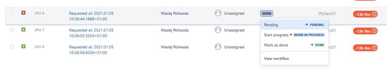

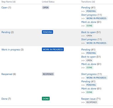

My workflow is defined as follows (it is default created by designer):
When I ues browser I can see list of transition:IssueList.jpg

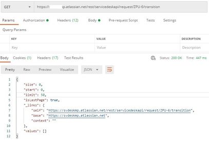

But when I try use TEST API I can not get get list of transition:
https://developer.atlassian.com/cloud/jira/service-desk/rest/api-group-request/#api-rest-servicedeskapi-request-issueidorkey-transition-get
Why I can not get list of transitions via the RESR API?

This is counter-intuitive I think and not explained well in the docs, but Issues are not the same thing as Requests.
A request is a wrapper around an issue, for the benefit of the customers - customers only see requests, but Agents get to see both the request and the issue behind it.
These two artifacts both have workflow elements.  The workflow for the issue is what you have given us a screenshot of.  The issue will be moved through that workflow by the agent.
But your REST call is trying to fetch the transitions for the request.  These are not the transitions in the issue workflow directly.  They are transitions that your admins have made available to the customer, which then transition the issue as well.  In this case, I suspect you have not made any transitions available to the customer on their requests, so the call to get transitions is returning empty.
Either you'll want to map some transitions for the customer requests, or, if you really do want to work with the issue transitions, use the Jira (Core) api for it - /rest/api/3/issue/{issueIdOrKey}/transitions

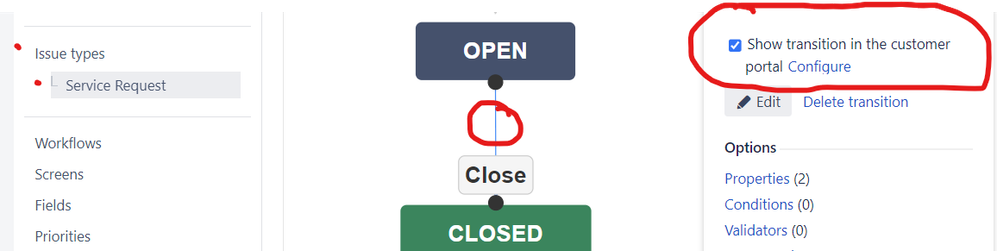

Hi! It helped, just one more comment about how to do that.
You need to:
  1. Open project setting
  2. Go to your concrete Issue type (!!!), in my case - Service Request
  3. Open Workflow view (top right corner)
  4. Press the Edit workflow button
  5. Select TRANSITION between statuses
  6. And finally enable required feature (Show transition in the Customer portal)
p.s. don't forget to ensure that changes were published.
After that, you can go to Help center, your ticket, and check that the transition to your status is available. You will see the transition name just below ticket status
