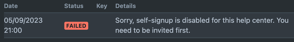

  • If it doesn't, check the logs for a clue. Even when I have restricted access to only allow added customers to send email requests, it shows in the log that it is blocked
