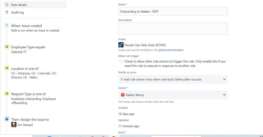

I somewhat inherited a Jira setup. As per the attached, you'll see that in this rule, if an issue is opened with certain employee types and locations, it will assign it to me (as a test.) But I have not been able to figure out where either Employee Type or Location are pulling their date from. I can find both of them in Custom Fields. But I cannot figure out, for example, to see the list. Let's say I wanted to change Salaried: FT to Salaried: Full Time or add some other employment type. Where would I find the ability to do that?

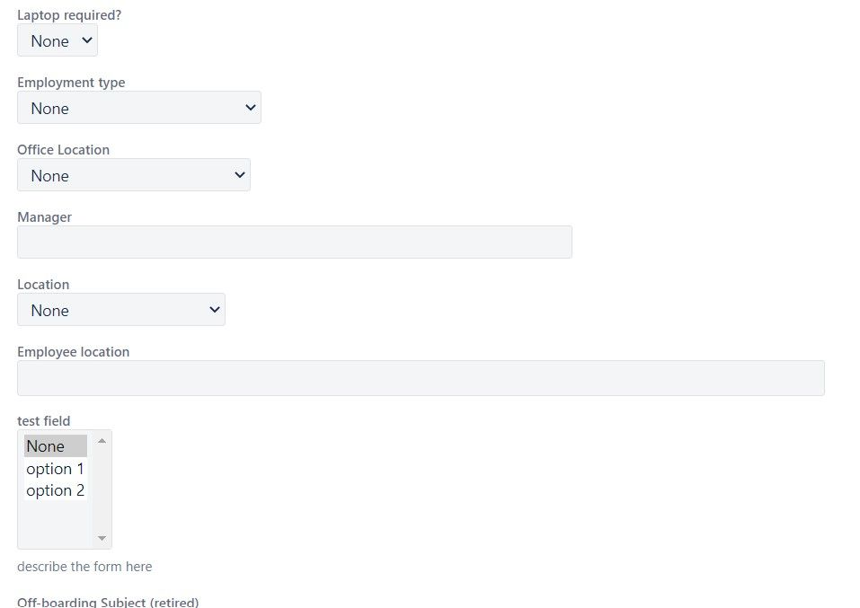

Well, in the interim I think I figured that out. Maybe. Here's where I am now. Essentially I'm trying to test a rule. One of the choices in the rule is Employee Type. (There is also an Employment Type but I don't want that.)

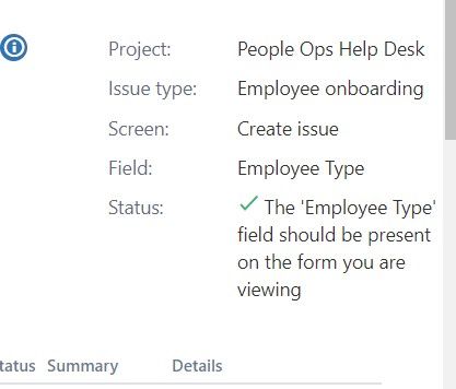

When I go to Create Issue to test the rule, Employment Type pops up but not Employee Type. I clicked on 'Configure Fields' and then 'Where is my field?' it tells me all is good and the custom field 'Employee Type' should be on this form. But it is not. I've looked at it 100 times. The one that IS there is 'Employment Type.'
So Jira tells me all is A-Ok but it's not. What am I missing?Partial issue screen.jpgWhere is my field screen.jpg

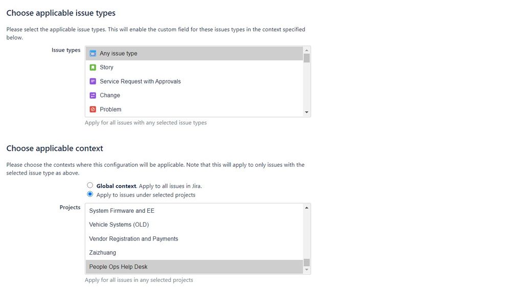

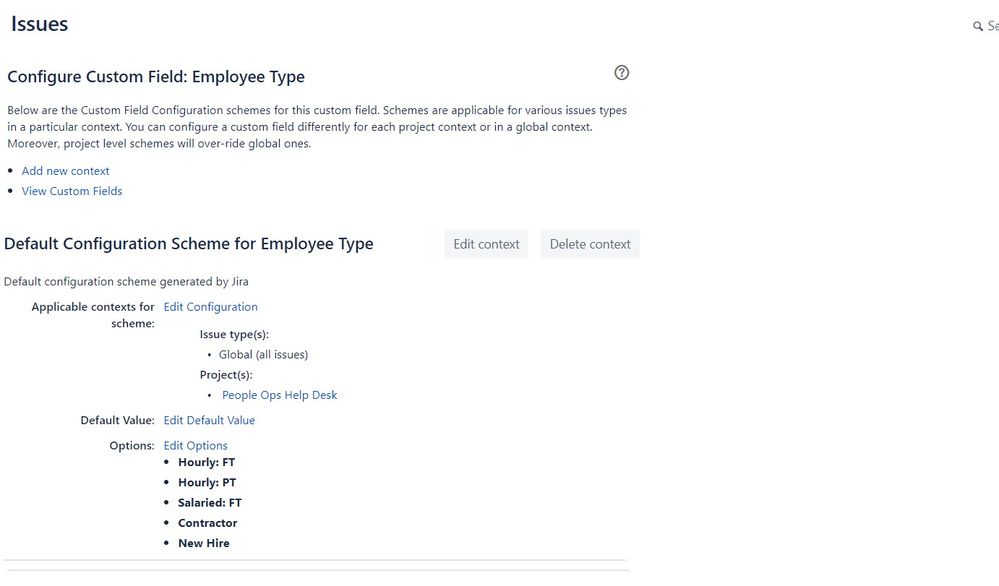

It does make sense. I'm still not there but I think I'm getting closer. You'll see the Employee Type custom field in the screenshot 'Employee Type Custom Field.' Those are the exact values I want to show up in Create Issue and then to be pulled in by the rule.
I then went into Edit Configuration and I'm supplying two screenshots because it did not fit on nne. I then went into Edit Context but that gives me the exact same screens as Edit Configuration so I am puzzled by that. (In Edit Configuration, I did make sure it was applied to People Ops project so that was a modification.)
Alas, when I go to Create Issue it continues to tell me that the Employee Type is on the form. It is not. Nothing has changed. I still see Employment Type. Edit Configuration 2.jpgEmployee Type custom field.jpg

This is a bit hard to debug without access to the system - but nevertheless.
On first sight I'd say there still needs to be an appropriate screen scheme assigned to your project while there is still a wrong one assigned (or a non-matching screen is assigned to the screen scheme). That would answer why you still see a field which you do not want to see but it will not answer why the "Where is my field?"-helper is telling the field is there - somewhat confusing!
Is there any probability that the field is on the screen - but in a second tab of the screen (in that case the theory that the screen/screen scheme needs still to be change can be neglected)?

Ok. I got it. The wrong screen (or screen scheme) was associated with the project. I fixed that and it worked as advertised. I think one thing that threw me off was this:
