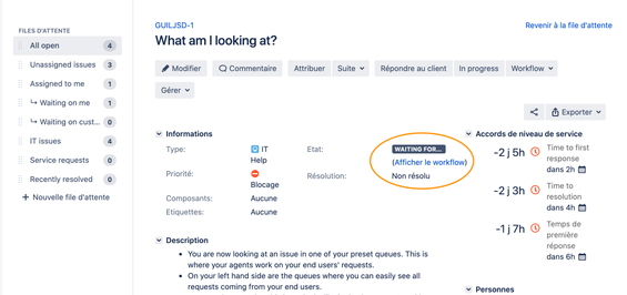

Guilhem Dupuy
September 16, 2020
Hello Claudia,
You can view the link between them by Viewing the Workflow :
  1. Select a specific ticket by clicking on its ID or on its summary.
  2. On the screen, clic on "View Workflow"
This will display the link between the different status and will help you understand how they work.
Let me know if it helped you or not,
Guilhem
