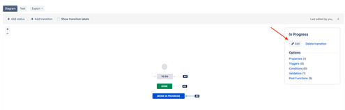

The dialog box displayed when transitioning an issue is basically a screen added to the workflow transition, the same kind of screen configured under your project settings > Screens to View/Edit your issues.
To properly add a screen to your workflow transition, you can follow the steps below:
  1. Navigate to project > Project settings > Workflows > Click to edit your workflow
  2. On diagram mode, click in the transition you want to add the screen > Edit:
  3. Select the screen you want to be displayed and click Save
  4. Finally, save the workflow draft
