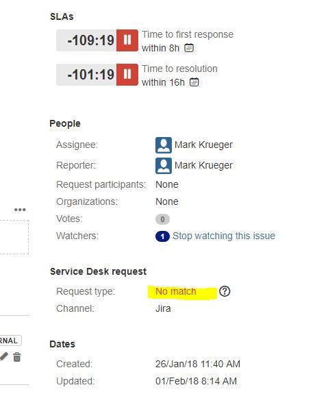

I'm trying to add participants to give them visibility to an issue. The participant is an external service desk customer, but they never get the email and cannot see the issue when they log in to the external portal.
Mark Krueger
February 16, 2018

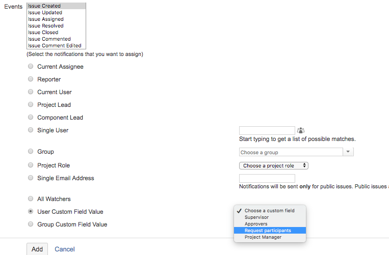

Notifications First:
Cog Wheel > Projects > (Choose your project) > Notifications (you'll want to add like you see below)

I figured out the reason why I can't assign participants. Its because when I create an issue, the request type is never pulled in. Once a request type is selected, then I can add participants.  I can't figure out how to add the request type field to my create screen so that it can be selected when I create cases. After searching your help site extensively I wasn't able to come up with a solution. Any suggestions?

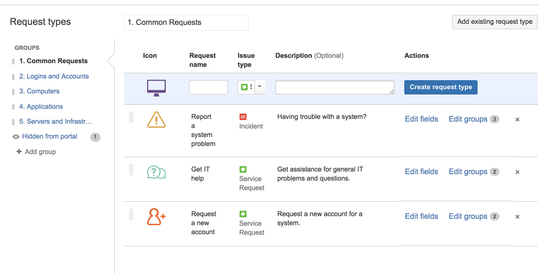

If you do not have request types, you can add some by going to the project > Request Types and you'll see the below image. Let me know if this helps.
Screen Shot 2018-02-16 at 8.34.49 AM.pngScreen Shot 2018-02-16 at 8.34.56 AM.png
