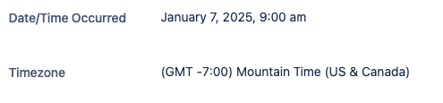

We ended up using a date/time AND timezone field in Jira @Curt Holley (which was implemented via our Jira Developer FWIW)
Ex. below
