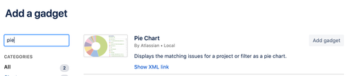

did you tried to set up Pie chart gadget on your Dashboard?Screenshot 2019-11-10 at 16.30.34.png
You can specify your project or JQL and then in Statistics type you select Labels to group data by them. You can set if you want the graph to be refreshed every 15 mins or just on page refresh (I think that page refresh might be enough).

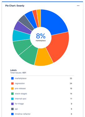

I got something like this:
