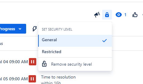

You and authorized users will need to change the Security Level associated to the issues to allow L2 users to access them. In your JSM project's permission configuration, there is a permission right named "Set Issue Security" which contains who are given the permission to manage the security level update at the issue level.

Here is the image where for users who has the right "Set Issue Security" permission assigned for the project will see in the issue view via project UI -
He/she will have the ability to switch the level assignment for the issues in question (i.e. switch to L2 users).
