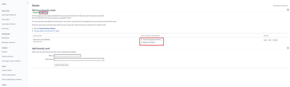

I've set an issue security scheme so that only the Reporter and Assignee are able to view an issue.
Still a customer is able to view the whole organization's issues.

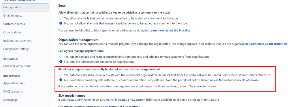

Also, the automatic new requests automatically be shared with a customer's organization is also turned off already. Jira2.png

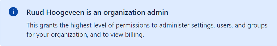

When I was still able to view, I was indeed a licensed Jira SM user/admin with the Org admin permissions (I assume I should be able to view everything, at any time).

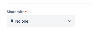

Based on my testing, if a customer is a member of an Organization then they will have the option to share their ticket with the Organization. They will see the Share With option when opening their issue through the Portal.
With the global option set to not automatically share issues with the Organization the field will initially show Share With No One.

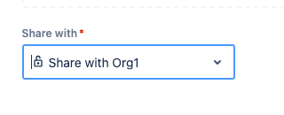

However the customer can change that to share with the Organization.
The only way you can prevent a Customer from sharing their ticket with their Organization is to remove them from the Organization.
The other possibility is that there is an Automation Rule that is automatically setting the Organization field in every issue.

Regarding your ability to see issues where an Issue Security Level has been applied, such issues should be visible only to the people specified within the Issue Security Level configuration for the level applied to the issue. If you are not within that configuration, you should not be able to see the issue. This does mean that issues can be made not visible to Jira Admins and Organization Admins.
A Jira Admin could circumvent this with their ability to modify the Issue Security Level configuration and add themselves to the configuration.
Note that the Security Level field must actually be set on each issue in order to limit the issue's visibility. If no Security Level has been set for an issue, then it is visible to anybody who has the Browse Projects permission for that project.
