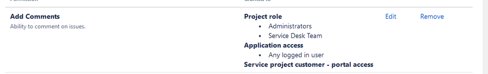

The Users are member of the project and have the role service desk member and developer. I have changed the permissions that any logged in user has application access and all users may add comments.

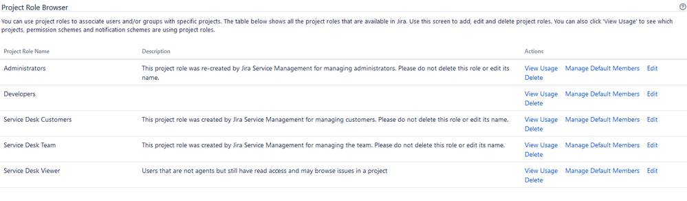

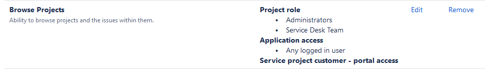

About the second issue i have checked the settings again and did not manage to solve this. As suggestesd in the Linked manual from the inital post i have  changed the permission scheme in one of the projects as suggested. Any Logged in user should be able to browse that project

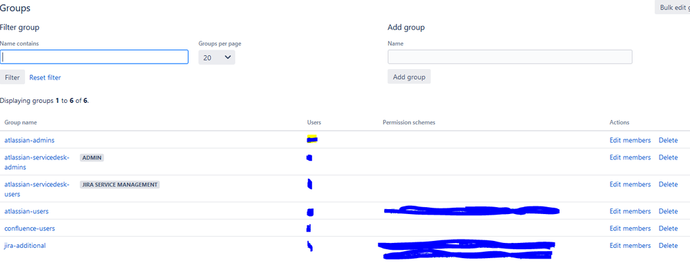

My Test User is member of the following Groups
And globally Part of jira-additional group

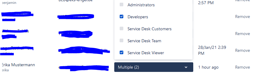

And finally the project Roles:
Im not 100% sure what you mean by
-->For your second issue, just to confirm, have you added the roles `jira-servicedesk-users` and `jira-software-users`?
Do i need to add these in the System project role setup given in the last screenshot?

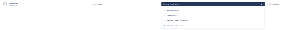

Then in the settings for the JSM project, navigate to 'Users and roles', locate the user you want to grant permission to and add grant them the role 'Service Desk Team':

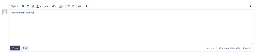

This should allow them to view and comment internally. This will not consume an agent license, for example this is the view they would see when commenting:

For your second issue, just to confirm, have you added the roles `jira-servicedesk-users` and `jira-software-users`? To have permissions to view and edit issues, the user needs to be added to the “Service desk team” using the default permissions scheme.
To verify what you have configured, I’d suggest navigating to one of the project which the users are not able to view requests on, go to the project settings → permissions and verify that the permission scheme is setup as you expect. For example, Browse Projects should be setup to allow the user group you want to grant access to. If this isn’t what you are looking for, it may help to provide more details via screenshots of what permissions you have configured.
