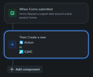

I'm having trouble creating an automation that uses a radio value to conditionally show or hide certain information.
The data comes from a form that eventually creates a new ticket in another project.
However, I made it simple to demonstrate the problem I'm running into.
  • I have an automation that triggers on form submit.
  • A lookup table called `radio`.
    • Key/value
      1/Yes
      2/No
  • A log to audit with `Developer: {{issue.forms.1fb00898-1f81-44d0-9617-91eecb5db6b3.last.isDeveloper}} | {{radio.get(issue.forms.1fb00898-1f81-44d0-9617-91eecb5db6b3.last.isDeveloper.value)}} | {{#if(equals(issue.forms.1fb00898-1f81-44d0-9617-91eecb5db6b3.last.isDeveloper, "1"))}}Yes{{/}}`

The component for creating the new ticket is directly after when the form is submitted.
I want to use the value in the 'Create a new' component. This is to dynamically include or exclude list items in the description field of the new ticket.
The automation is very simple.
Where the description of the new ticket contains:
*Summary:* {{issue.summary}}
*Description:*
{{issue.description}}
*Accounts:*
{{issue.forms.1fb00898-1f81-44d0-9617-91eecb5db6b3.last.accountDetails}}
*Products:*
{{issue.components.name}}
*Actions:*
{{#if(equals(issue.forms.1fb00898-1f81-44d0-9617-91eecb5db6b3.last.isSupportDesk.label, "Yes"))}}* Create a support desk invite.{{/}}
{{#if(equals(issue.forms.1fb00898-1f81-44d0-9617-91eecb5db6b3.last.isDeveloper.label, "Yes"))}}* Create a license.{{/}}
The 'Account' part of the description works as you'd expect. The 'accountDetails' are shown in the newly created ticket coming from the form.
The 'Actions' part of the description I'm trying to simulate by using the 'Log' component of the automation does not.
So far I've tried:
  • {{#if(equals(issue.forms.1fb00898-1f81-44d0-9617-91eecb5db6b3.last.isSupportDesk.label, "Yes"))}}* Create a support desk invite.{{/}}
  • {{#if(equals(issue.forms.1fb00898-1f81-44d0-9617-91eecb5db6b3.last.isSupportDesk, "1"))}}* Create a support desk invite.{{/}}
  • {{#if(equals(issue.forms.1fb00898-1f81-44d0-9617-91eecb5db6b3.last.isSupportDesk, 1))}}* Create a support desk invite.{{/}} (as a last effort but obviously `1` is not a variable.
In these tests 'equals' always returns false.
The comments prior to this are simply to get the smart value to display using the Log component to prevent creating new tickets each time I test it but I can't seem to get it right.

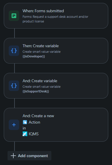

Great tip. Using the 'Create variable' seems to work weirdly enough.
Then, in the smart field:
{{issue.forms.1fb00898-1f81-44d0-9617-91eecb5db6b3.last.isDeveloper.label}}
And finally using:
{{#if(equals(isDeveloper, "Yes"))}}* Create a license.{{/}}
I wouldn't have figured this out using the documentation, and it's counterintuitive but it works.
Thank you for the help.
Like • Marc -Devoteam- likes this

As @Marc -Devoteam- notes, using the Create Variable action to first store a smart value and convert it to text can solve several challenges in rules:
  • Timing / racetrack errors
    • Some smart values are looked up just-in-time.  Because of that they may not be fully evaluated before they are needed in some rule expressions, leading to a null value being used.  This happens frequently with the Edit Issue and Send Web Request actions with JSON, and with the Send Email action's body.  The solution is to use Create Variable as it will fully evaluate and store the result before the next rule step proceeds.
  • Data type incompatibility errors
    • Some smart values preserve the data typing (e.g., integer, dates, text, JSON objects, etc.) and thus might not be compatible with some rule features.  The lookup table's get() function is much more forgiving than other rule features, but it cannot handle everything.  Storing a value in a Created Variable forces it to text, which is quite helpful as it is a known starting point to perform other rule actions or type conversions.
And, please note well: when using the Create Variable action, I recommend always using a name which cannot overlap with other field / smart value names.  This will prevent the rule processing, and people reading the rule, from getting confused.  For example, I always add a prefix to variable names, such as varIsDeveloper.
Kind regards,
Bill
