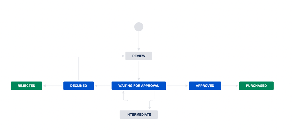

I found the notification settings you mentioned and noticed that it seems to only trigger when it moves through the workflow (lame). I attempted your solution but wasn't having much luck. I would receive the email but Slack wouldn't ping me.
I tried creating an automation that cycles on the same status "Waiting for approval" and it didn't work.
I then created another status, Intermediate, (using the link I mentioned above) and automated it through that status instead. Below is what helped for me and so far so good.Screen Shot 2022-10-11 at 4.33.01 PM.png
