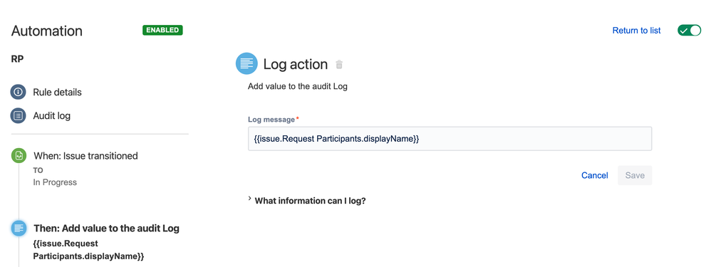

Here is a screenshot of my setup:

I also tried this, and it also works:
{{issue.customfield_10702.displayName}}
It seems you have already tried this. I am not sure why it is not working for you. Try printing the value to the audit log and post what you see there.

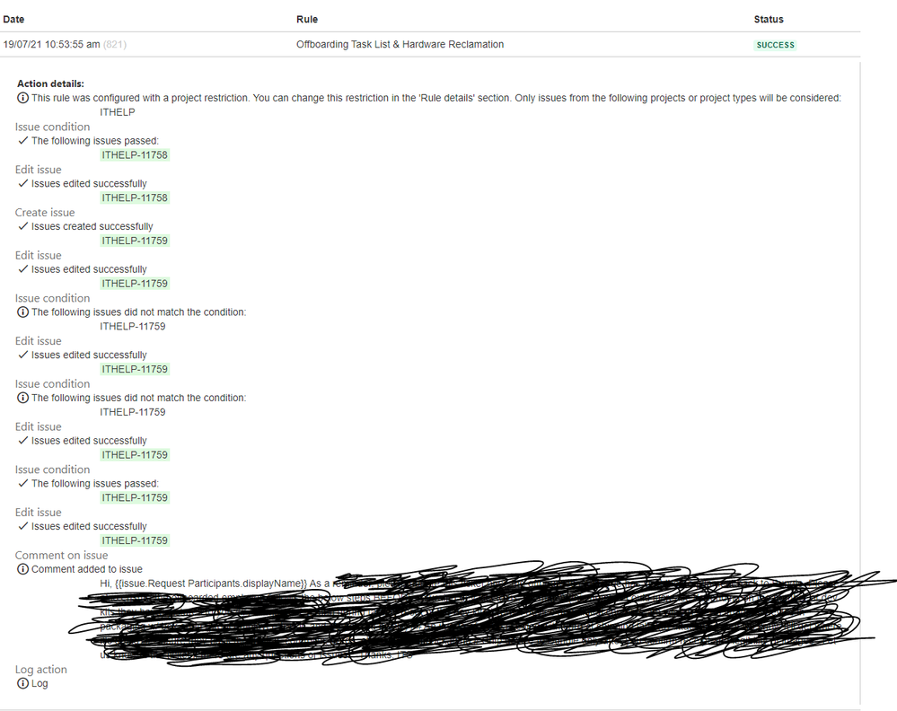

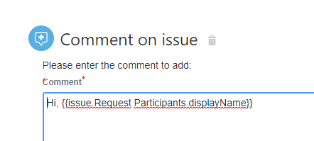

I added the 'Log Action" step as you have above. it just shows that the rule ran successfully, but in the comment shown in the ticket, it's blank. I attached some photos below.

forgot the one of how it shows in the comment

I got it! Thanks for pointing out 'print to audit log' that helped hone in on the issue for sure. I setup a new rule to do that after it didn't show anything much when adding it to my initial rule and saw it populate correctly.
I think the issue is something to do with the fact that I set the "Requested Participants" value just above the "add comment to issue". It was set to be copied from the trigger issue and then comment on the ticket. I'm thinking that the automation isn't realizing that the "Requested Participants" is actually set yet/it is seeing it as a null/empty value.
To get it to work I used the {{triggerissue.Request Participants.displayName}} command and that took care of it for me.
