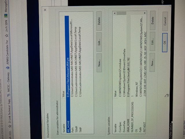

That JRE_HOME path looks a little wacky. Can you set the correct location as an environment variable for the user that you are starting Jira with?
I'd expect it to be something like this path
E:\Program Files\Atlassian\JIRA\jre
