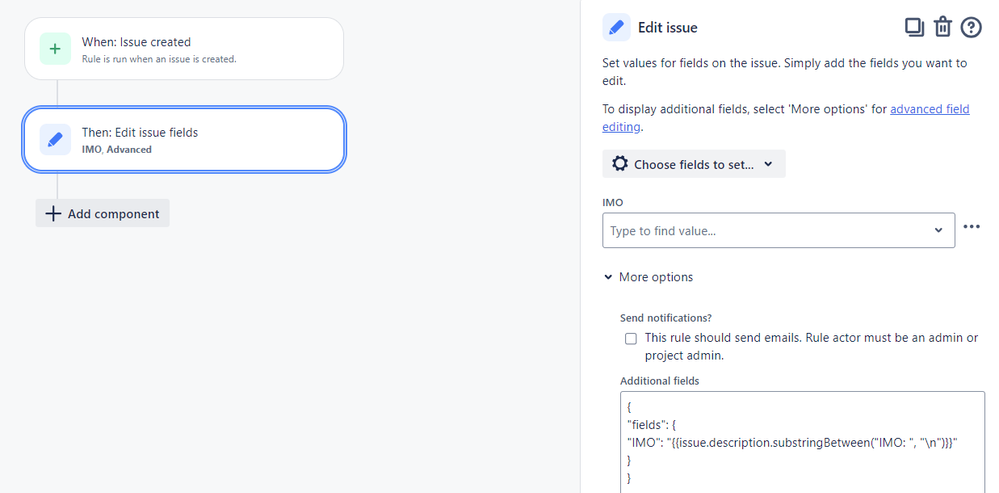

could you like screenshot your flow or something, so I can understand better?
David Clark
July 22, 2024
Manav Shah
July 25, 2024
"fields": {
"customfield_XXXXX": "{{issue.summary.match("Part#\d+")}}"
use custom field ID, don't use the name of field. try it once
