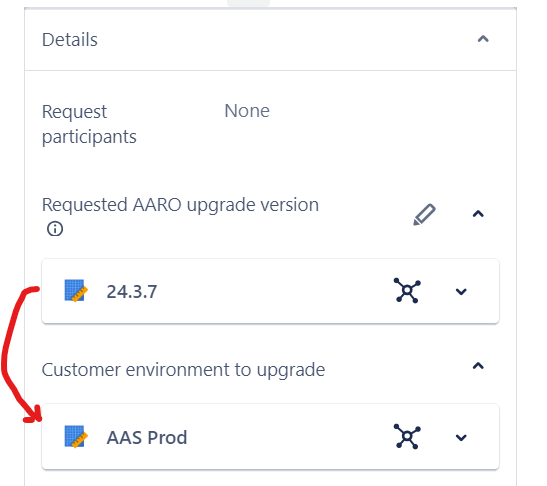

- We are having an issue type, called "Upgrade Projects", where we upgrade a software to a higher version. When creating this issue one has to state to which version, which module will be updated. These are two separated Asset custom fields.
- The issue itself is connected to a customer Asset object via a issue asset custom field. This customer then has one or multiple environment, another linked Asset object. These are test and production environments.
- When a upgrade project is finished, transitioned to DONE, the productive customer environment gets updated with the upgrade version manually within the right asset object.

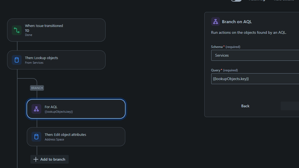

What you described is doable using Automation smart values - Assets
  • Trigger: Issue transitioned
  • Add a Lookup objects to search for the asset that you want to update (you can get the key from the Asset field that is associated to the issue)
  • Add a Branch to update the correct Asset
  • Action: Edit Object attributes using the field smart value.
Example:

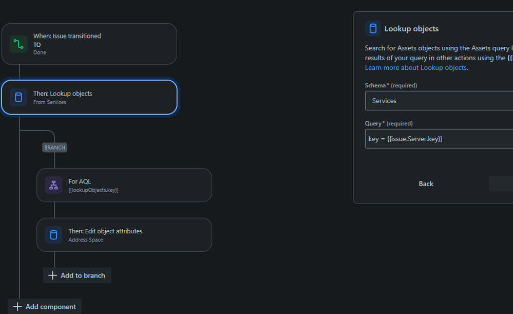

  • For the lookup query, I guess the "Server" part is the variable where as the other part are fix. What represents the "Server"?
    • The Asset object itself or the custom field on the issue

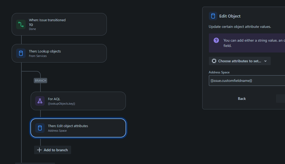

  • I have to write the lookup value from one Asset custom field and then write it as a value into the attribute of another Asset object (see the following screen shots).
    • What is the best approach for this scenario?

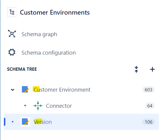

This is the setup in the Asset schemeAsset_CustomerEnvironment and Version.png

In the automation example, the "Server" field is the Asset object, from the issue you can access any of the attributes using smart values
Using the same smart values you can update other Asset objects using the Edit Object action in Automation.

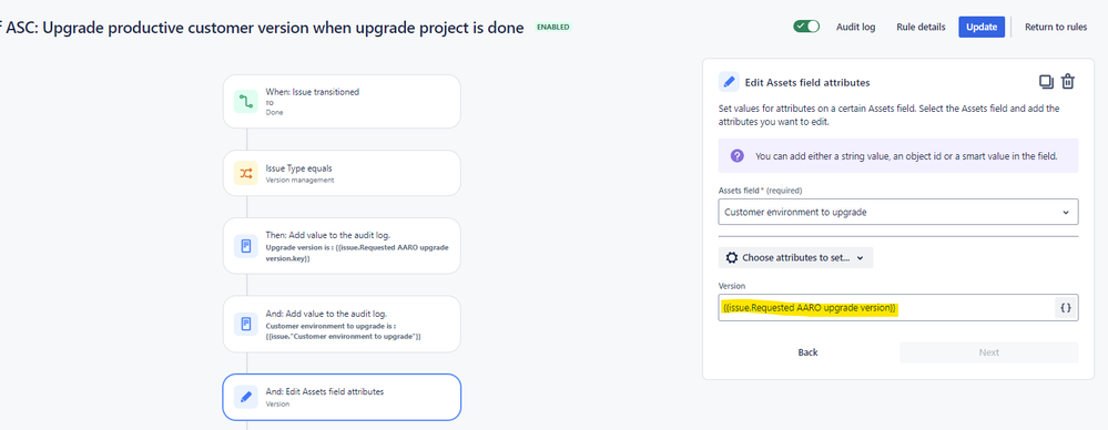

It took me a while, but actually even easier than I thought.
I could use the "Edit Asset field attribute" action as follows to overwrite the Asset attribute value with the updated version of the right customer environment.
I didn´t get that one can use the "Edit Asset field attribute" action to update the Asset attribute value of the Asset object. I thought this will only update the Asset value on the issue, but not the actual data within the Assets.
In hindsight this makes sense now, but I guess this is always the case.
