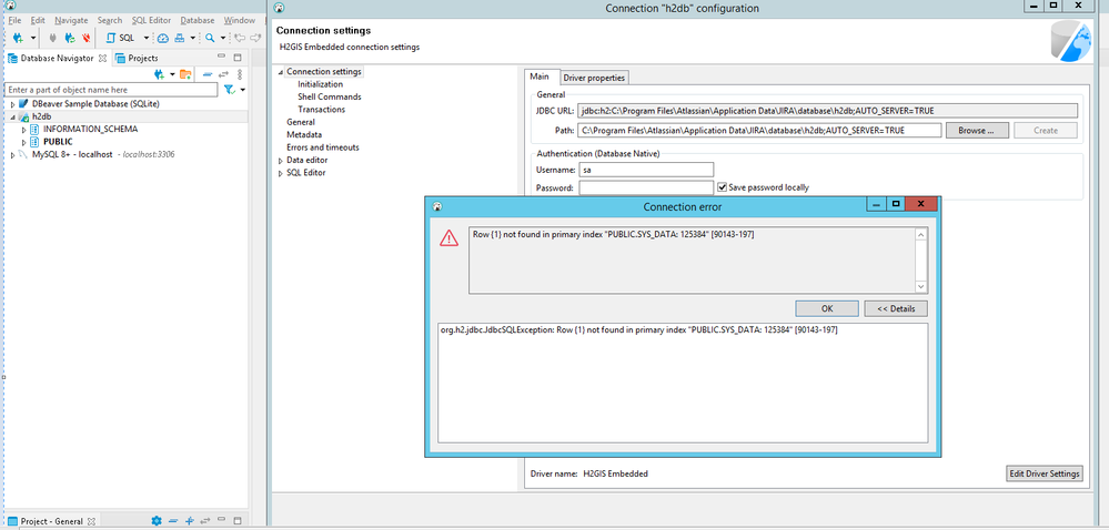

Hi Team,
Getting this exception while trying to read the database which is in the dbconfig.xml.
The Database configured is H2Embeeded database.
Please see the exception which is occurring while connecting to the same database from the DBeaver Client.The size of the DB file is 24GB...
I am not able to track anywhere that it is trying to read the database file of H2, but while stopping the JIRA Service it is trying to read.
Pattern is it is checking the MYSQL Database file and stopping to start the JIRA since no database is available.But we have the H2 DB Configuration in the dbconfig.xml file.
We need the JIRA download for the 8.2.2 Version which we will cross check any jars are missing.
Nic Brough -Adaptavist-
June 3, 2021
You are "barking up the wrong tree" here.
When you say "Pattern is it is checking the MYSQL Database file and stopping to start the JIRA since no database is available.But we have the H2 DB Configuration in the dbconfig.xml file."
That is not quite what it is doing.  As I said before, what it is doing it trying to read the H2 database, failing, and then moving on to do a general database health check, which is throwing the error about a missing mysql driver.
While you are missing the mysql driver jar, that is not the problem here.  You are missing it because you have to install it manually due to licence restrictions if you want to use MySQL for the database.   You didn't install it becuase you went with h2.  But you don't need it, and all it will do is remove the mysql driver error from the logs.
The rest of your errors will still happen, and your Jira will still fail to work.  Just installing that driver is not going to fix your problem, you've got a broken h2 database and you need to fix that.
