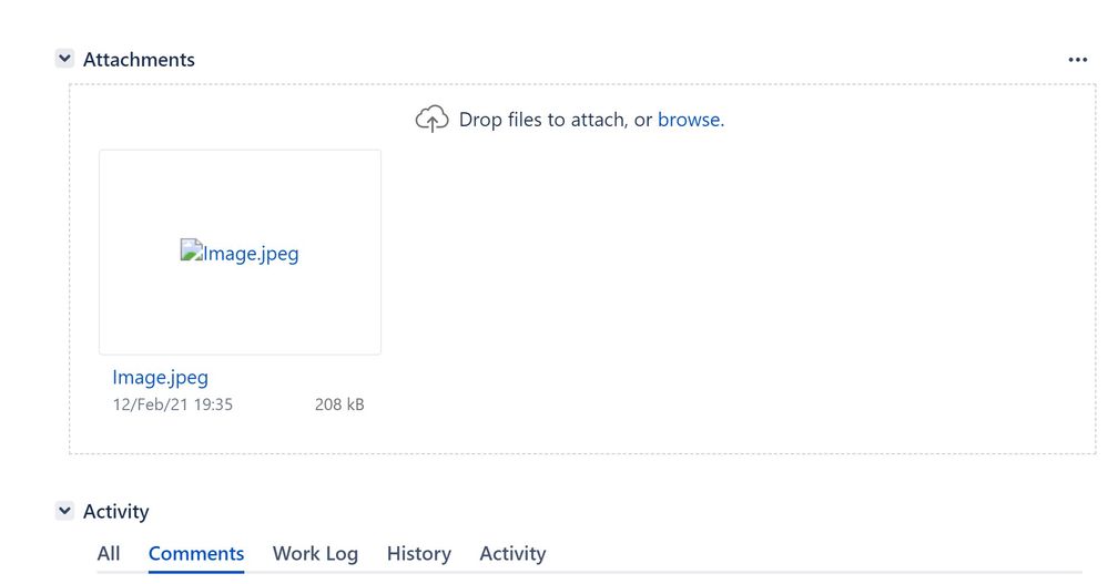

We just upgraded our local server edition of Jira from 8.14.0   to  8.15.0  . After this, It is not possible to view attachments ( .jpg ,  .PNG )  on most of our service desk cases. We have tried on several PC's and tried Edge, Chrome, IE .

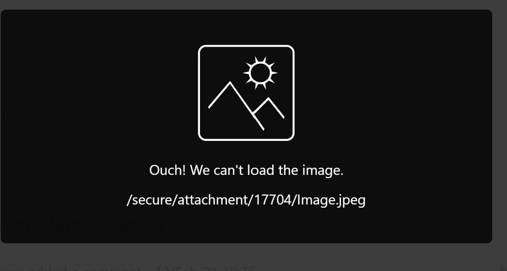

Thank you.  I downloaded the Jira-Core_8.15.0-X64.exe  from the Atlassian homepage and ran it on the server. This is the method, I have used ( many times) in the past to upgrade. There were no error messages and such during the installation/upgrade. Afterwards, everything is in order, except the attachments in our service desk case.
Here is a screenshot :ServDesk_error.jpg
Clicking the link to the picture, give us the ""Ouch! We can't load the image."

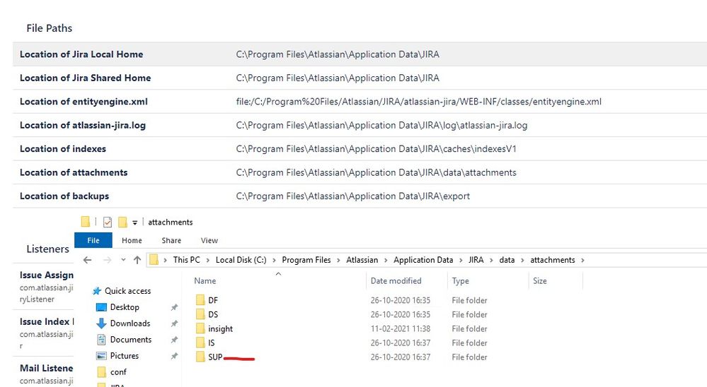

Can you go to Admin > System > System Information and find where the app thinks your Jira Home directory is? Compare this with the actual location of the attachments. Also, have you reviewed permissions on the attachment directory / files? Cheers!
SysOp
February 16, 2021
Hi

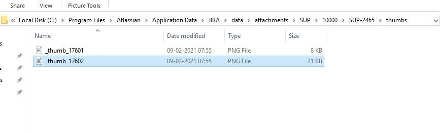

Thank you. Following is the path in JIRA, and the actual folder structure on the server. DF, DS (Development SCRUM), IS (Infrastructure SCRUM) and SUP ( Support Desk ) are our projects in Jira.
It seems to be correct according to the JIRA documentation.
Furthermore, the actual files are located here :

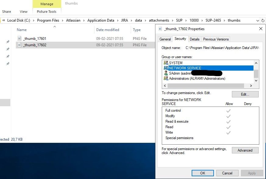

I am a bit unsure about the permissions. I am starting the JIRA service by "NETWORK Service".  This "user" and the admin user which I used to install the program, has Full control NTFS permissions on all the JIRA folders. I have double-checked that all the permission are inherited. The permissions are like this
