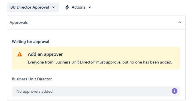

We have a bunch of tickets in our system where they are at a 'Waiting for approval' status -
The issue is, we cannot select any approvers as the group says 'No approvers added'
When I go into this group there are 12 users within this group -
How can I get these users to show on this step?

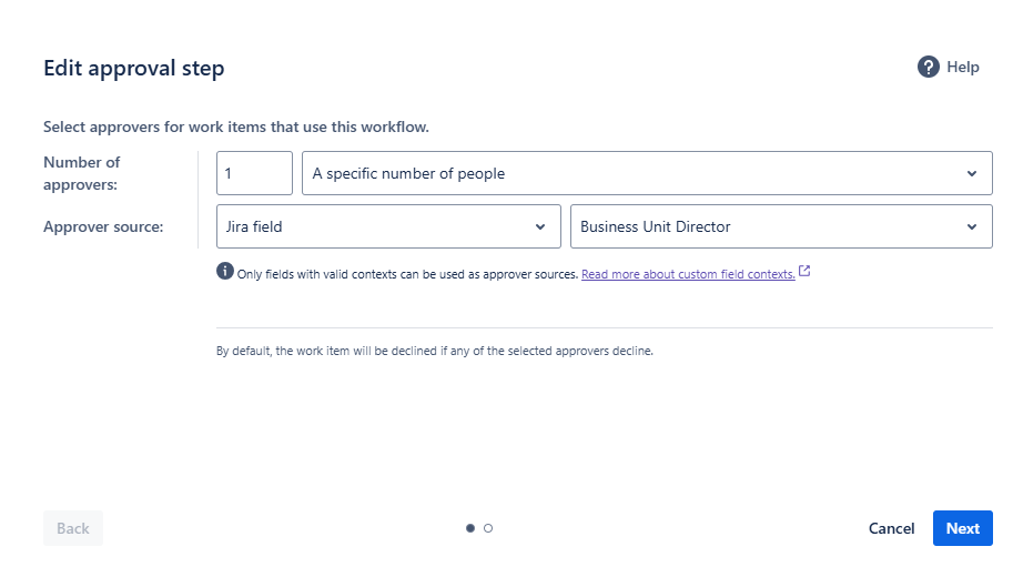

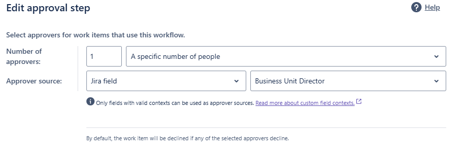

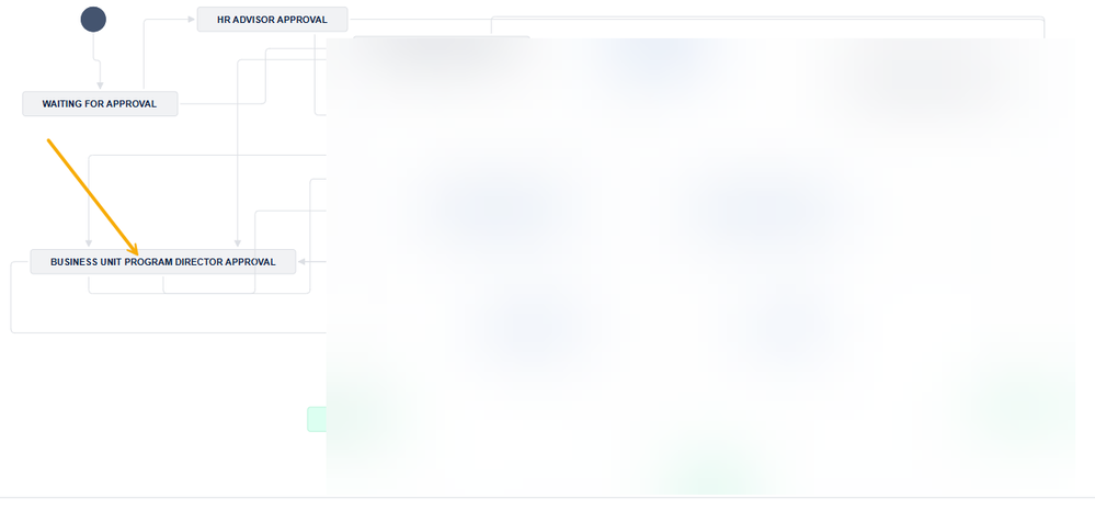

Within the workflow under BU Director Approval, it has Inc. Approval Step

In your configuration of the approval step you specified that the Approvers for a given issue will be the people specified in the Jira field named "Business Unit Director".
As the requests are created or progressed through their lifecycle you need to fill in the Business Unit Director field. The values specified in that field will determine who can execute the Approve action for the issue.

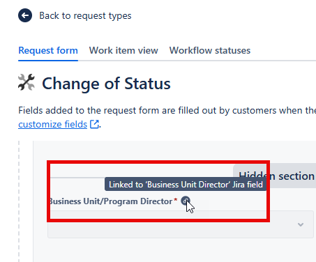

Did you add the Business Unit Director to the Request Type? Looking under Request Type, under this particular request I can see the drop-down selection with the Jira Field

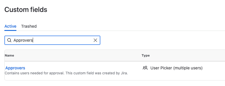

When I asked about the type of field for Business Unit Director, I'm asking if it is a User picker field, a text field, etc. Get that information by finding the field on your Custom Fields list (available to Jira Admins from the gear icon / Work Items / Custom Fields). i.e.

The Approvers field under Custom Fields is 'User Picker (multiple users)'
