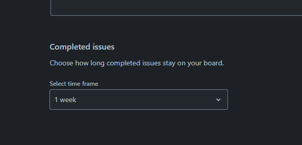

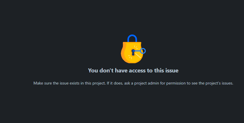

I have setup my board to hide done issues after 1week, but when I click in view older issues it shows error.
See the below screenshot:
Does hiding issues delete them completely?
Settings screenshot:

Hi @Ayush Lawania
they are certainly not deleted. Interesting message anyway.
I just tried that out and have the same behaviour. It looks like the Link is putting together a really random JQL search that results in that error.
You can find older issues by either clicking the "issues" tab in your project or just use the normal search and filter for your project and closed issues, for instance with:
project = xxx and status = Done

Hi @Rebekka Heilmann _viadee_ ~ I used a URL encoder and found that when that older issues link is clicked, there is a { symbol in the URL that shouldn't be (indicated by the %7D shown below.)
https://yoursitename.atlassian.net/issues/%7D?jql=
If I remove that portion, the JQL works fine for me.  Can you include this in your correspondence with the Atlassian Team?

Hello @Ayush Lawania ~ this looks more like a permissions or Security Levels issue.  Assuming you are the Jira Admin, check the Permissions Scheme and Issue Security Schemes to determine if on of those reasons are the culprit.  Another thing to check is Archiving.  It may be that some older issues have been archived.  A quick check to determine if this is the cause, is to enter a direct link to an older issue (i.e. https://yoursitename.atlassian.net/browse/ABC-1).  HTH
