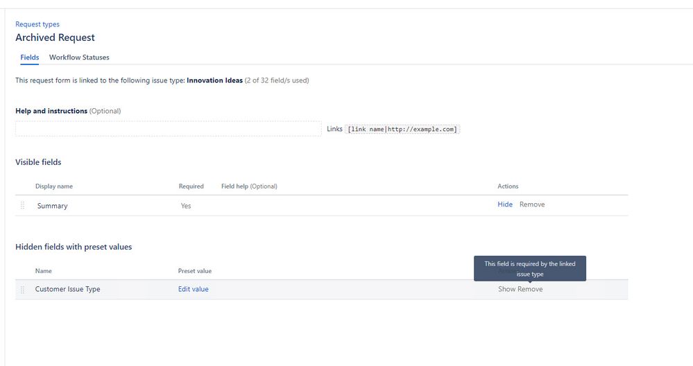

I have a existing request form that has a custom field type "Customer Request Type" from add on Extensions for JIRA Service Management that is located in the hidden section on the request form with a value set.
I need to remove it as it is not supported to migrate from server to cloud.  It fails the migration.
The action section shows Show and Remove links and they are both greyed out.
I hover and it displays the field is required by the linked type.
I check the field configuration and it is optional.  I check the create screen and the field is on the screen.  I check all the other dynamic form configuration and the field is not used in it.
I do full reindex.  does not solve it.
Anyone have any ideas?      without re-creating request forms as there are many and have a lot of dynamic form configuration.

I ended up deleting the custom field from the admin/issues/custom fields page.  It was then not showing on the request type as well.  I did this approach because I did not need the field to be migrated at all.  This solution will not work for all use cases.

Since this custom field "Customer Issue Type" is sourced /associated when you implemented the add-on Extension for JSM and not native to JSM, you have two options that I can think of -
  1. Disable and uninstall the add-on.  It should remove the field.
  2. Contact add-on vendor for direct support of your issue.
NOTE - From your updated screenshots, it is not the field named "Customer Request Type" which it is native fot JSM.

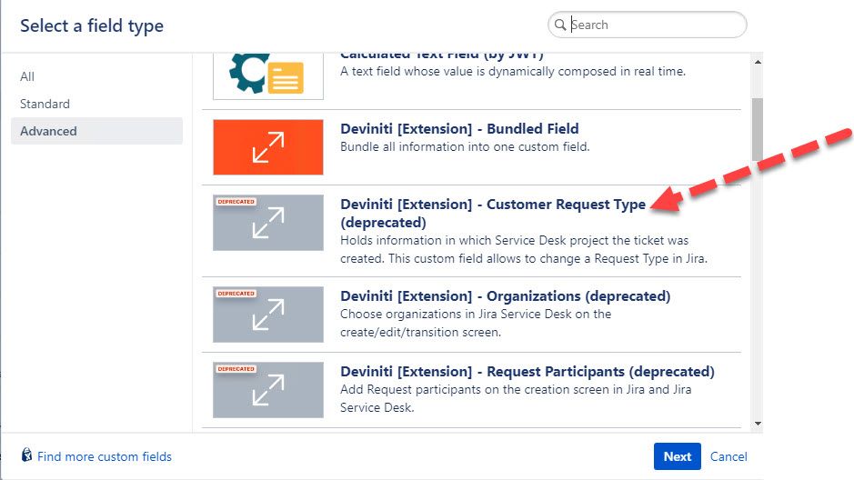

Dave Mathijs
April 22, 2022
Hi @Sheral Hewes ,
Customer Request Type is an essential field in JSM.
Can you share a screenshot please to indicate how Extension for JSM creates another custom field?

Sheral Hewes
April 22, 2022
RemoveField1.jpgField is Customer Issue Type
